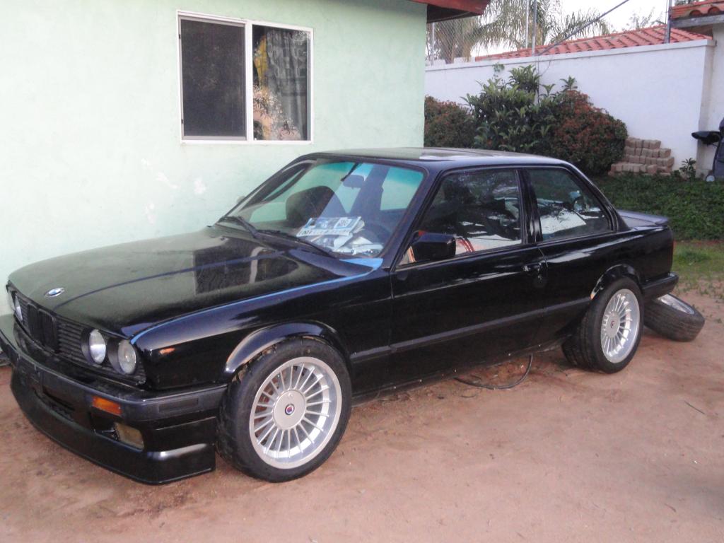

Here is my E30 when I had Rondell 17x8.5 +13 front and rear. I have massaged and slightly pulled fenders, H&R sport springs, billies sports, and Nitto 235/40/17 tires
Some pics:
