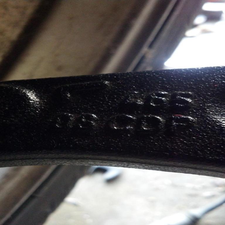

Now for the front I have 98 M3 spindles(907 and 908), MZ3 Control Arms(465 and 466) and THR offset CAB's.

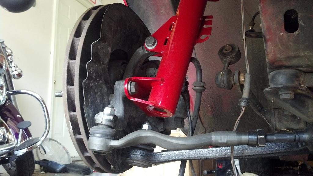

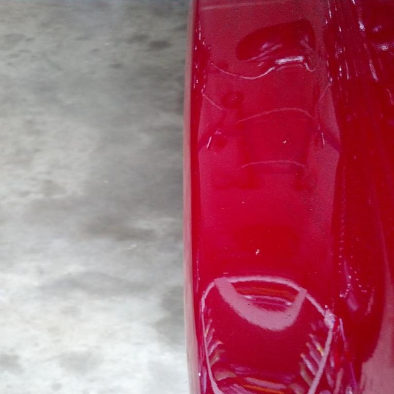

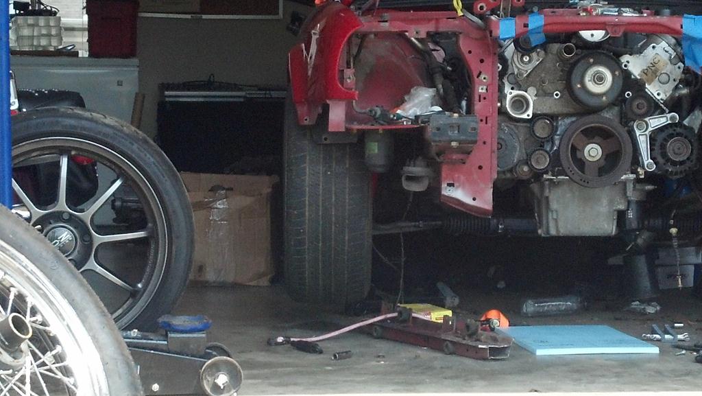

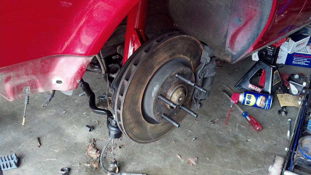

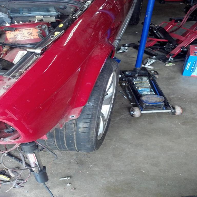

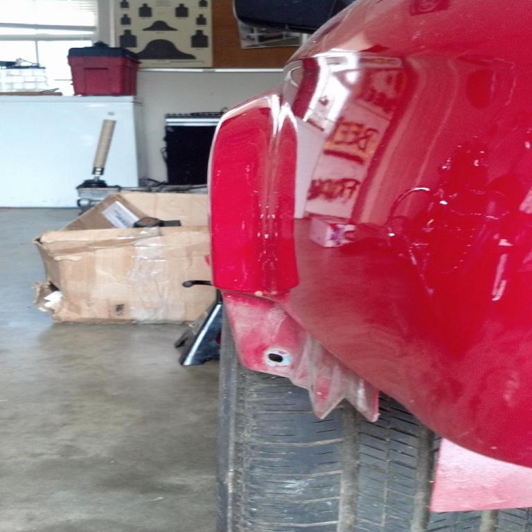

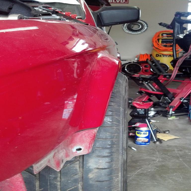

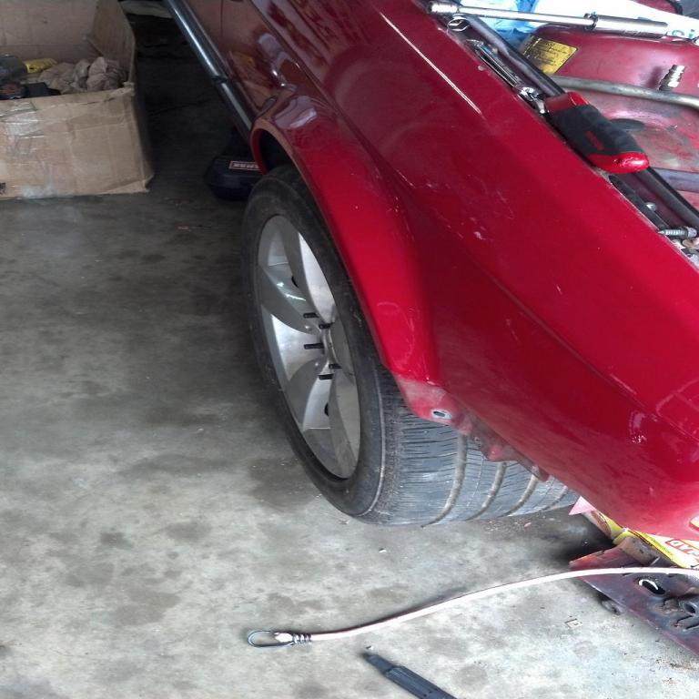

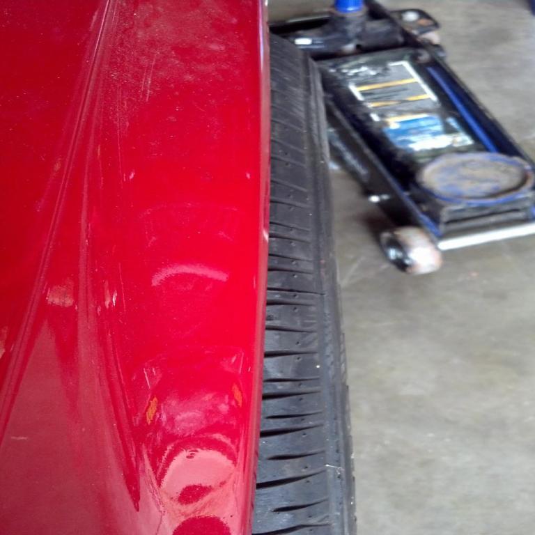

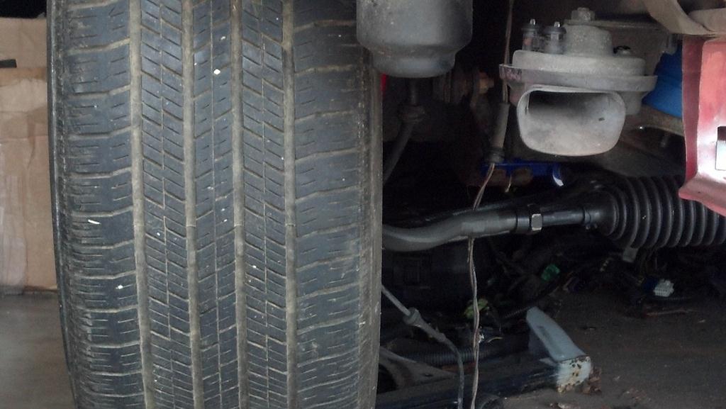

On mthe drivers side the wheel pokes out about 1/2' from the fender where on the passenger side it sits about 1/4" inwards of the fender, which is where I presume it is supposed to sit. I tried 2 different sets of wheels and swapped the wheels side to side. If I adjust the camber with the camber bolt on the drivers side as far negative as it will go, and then pull the camber drivers side camber plate max negative, it is still more positive then the passenger side at max positive!

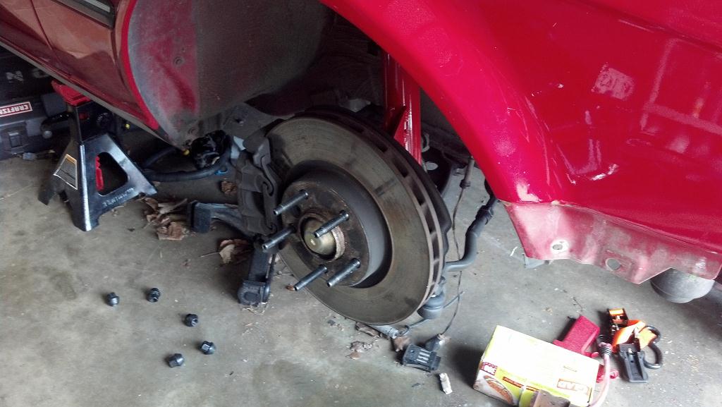

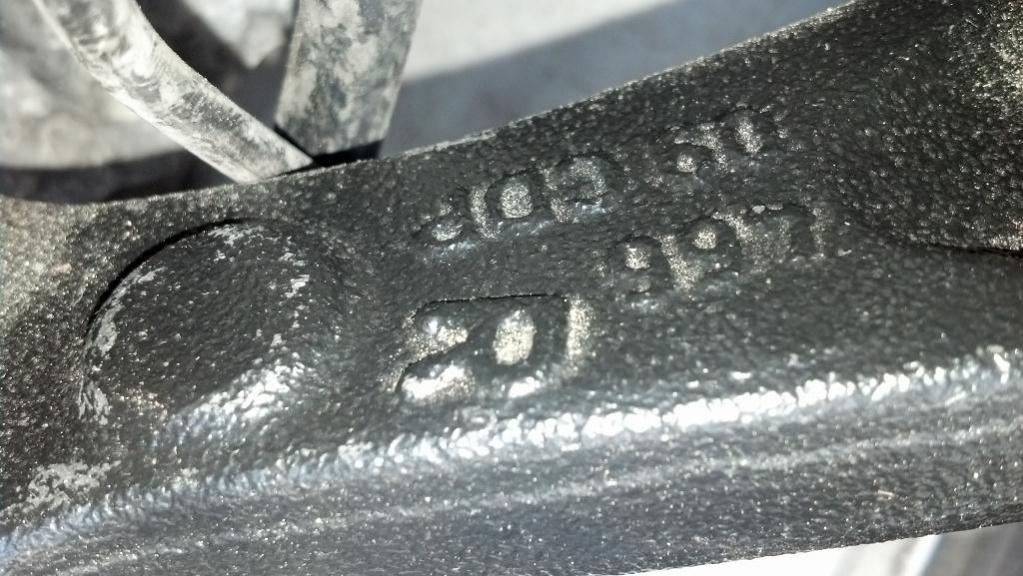

I took everything back apart tonight and double checked all my partnumbers and checked for proper assembly, which it all seems good.
There are 2 theories I have at this point and time..

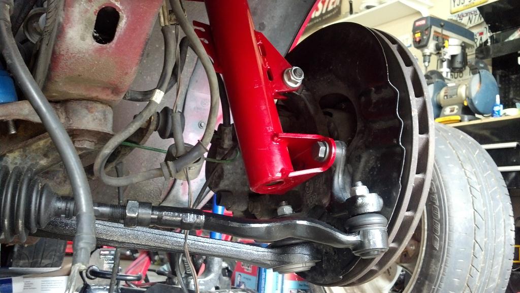

1st. my 907 spindle is bent, which I doubt, for it installs rather easy and the bearing still runs smooth, but you never know.

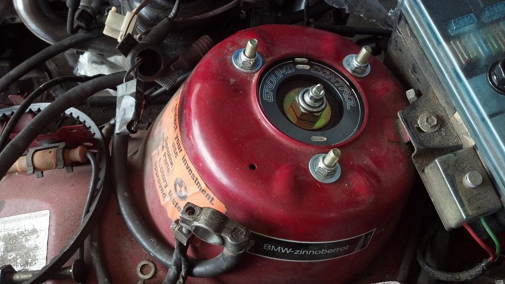

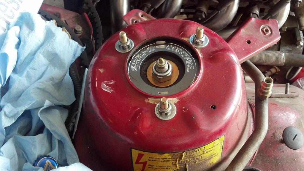

2nd. My Ground Control front strut housing might be for a non-M spindle. [EDIT: Talked to Ground Control, even if this were the issue it wouldn't cause this!]
I measured from the the upper outermost portion of the brake rotor to the strut housing. it was a touch over 5" on either side or 13cm.
if there was any difference between left and right it certainly was not enough to warrant the vast difference in wheel position.
I also verified the subframe as being straight and true !
Now I have to admit the car has not had an alignment yet, as there is no engine in it and I am in the middle of swapping engines as well.
Has anybody else ran into this issue?
Thanks in advance
Phil
