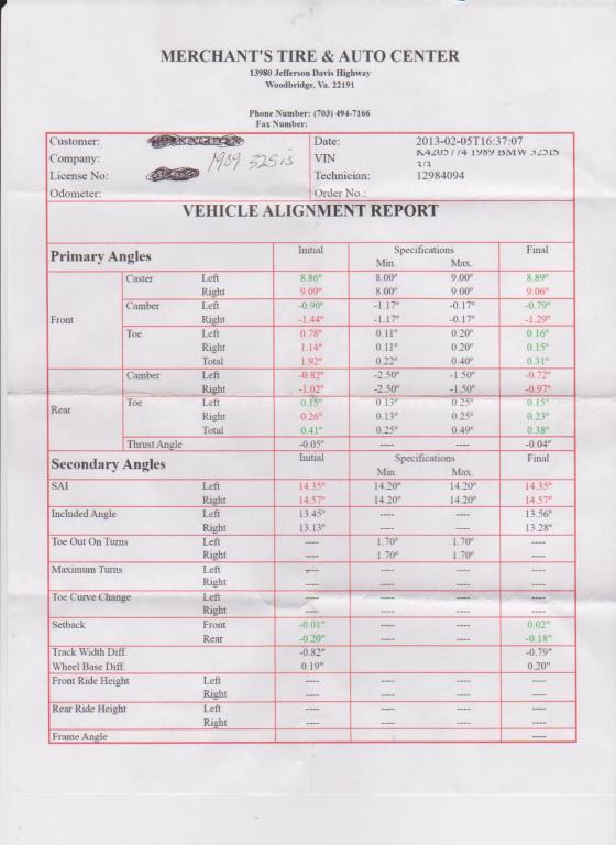

    Does this seem like a pretty complete lists as to what i need for my 5 lugs? thanks and here she is.\
    Got everything done with alignment specs
