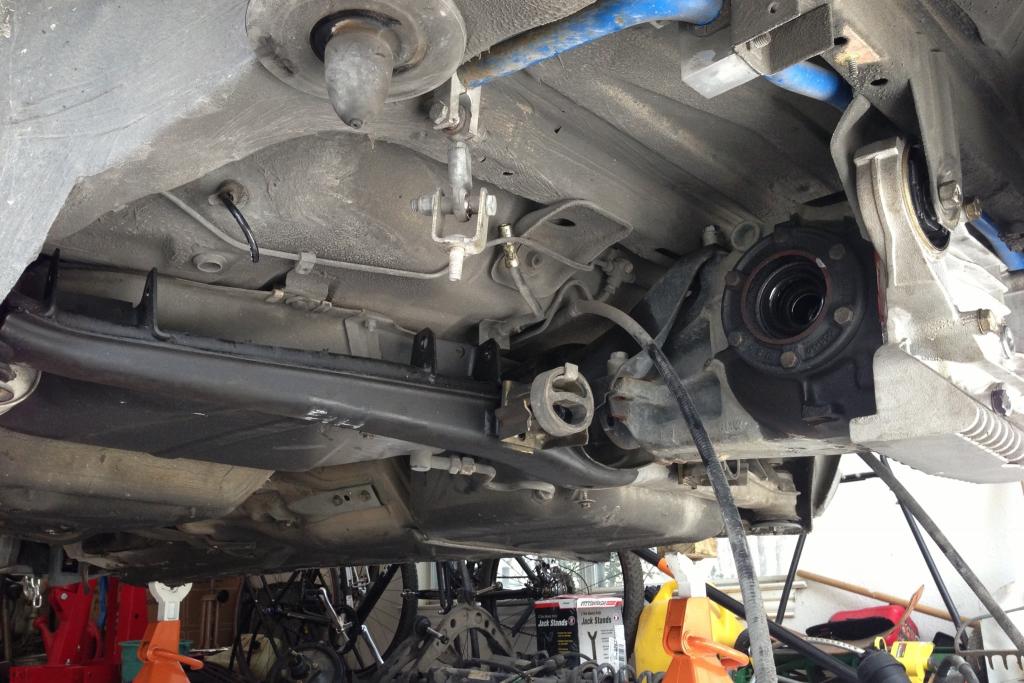

        So I pulled the crossmember from my car yesterday, and for shits and grins I thought I'd try and bolt up the Z3M crossmember/diff....

          Hey man your car's upside-down.

            Thanks fixed

              I looks like the only difference is the bushings are shorter, and an additional exhaust hanger...

                But it definitely looks like it fits...
                Matt, how come you said it doesn't fit? Different P/N?

                  It is a different part number.
                  I was actually told it didn't fit by Jordan years ago. His info was usually spot on so I did not question it.
