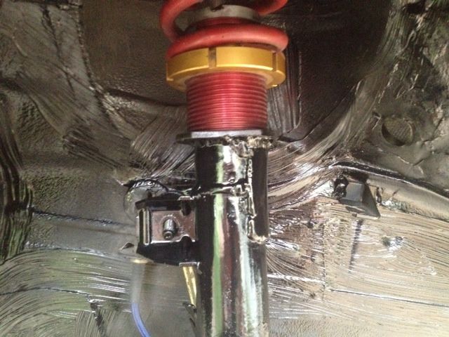

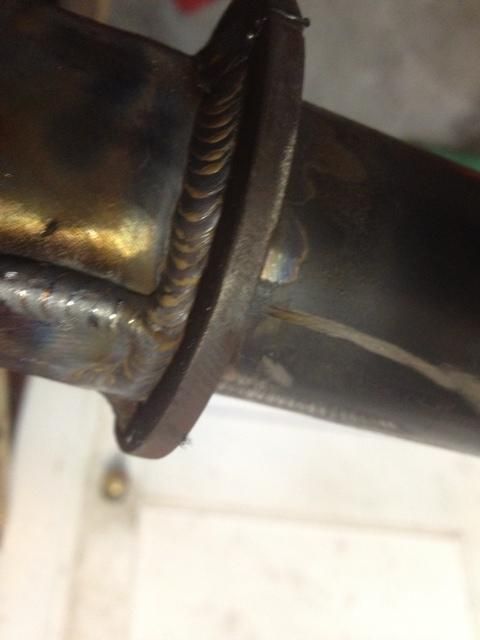

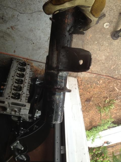

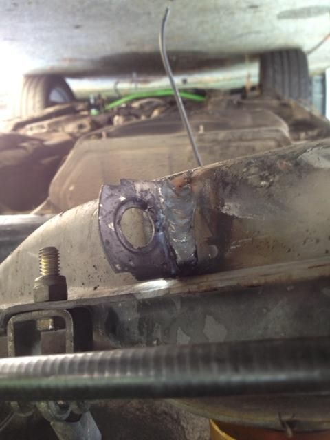

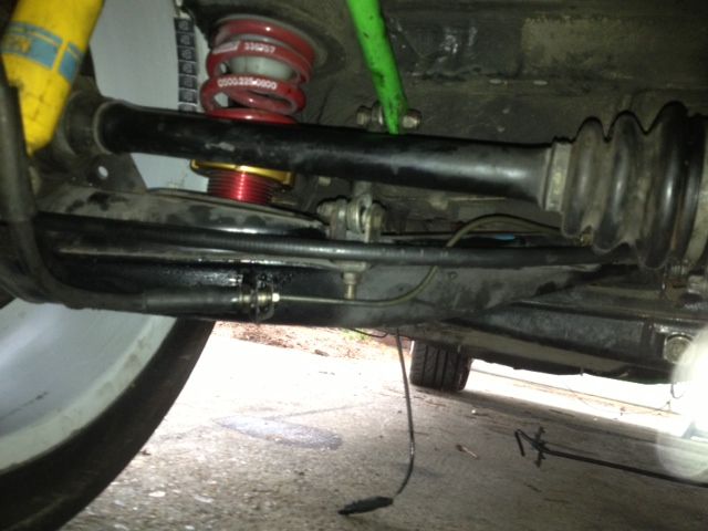

    I just finished up my 5 lug swap on my E30. Here's the set up...
    There's no interior or top end/ turbo on the motor. The ride height will be adjusted when it's all back together.
    Rear:
    -E30 Subframe
    -Mcoupe 3.23 Diff
    -Mcoupe trailing arms
    -Mcoupe brakes
    -Ground control E30 coil conversion
    -E30 Bilstiens
    Front
    -96+ Control arms
    -M3 Brakes
    -Tree House FCAB
    -M3 Strut tubes
    -E30 Bilstien Inserts
    -E30 Ground Control coil conversion
    -Ground control race camber plates
    I had to make a set of short, 12" brake lines and I cut the brake line guide/holder off my E30 dust covers. I then welded them onto the trailing arms.
    I really wanted to retain my ground control stuff and really didn't want to buy an E36 set up so... I cut the E36M3 strut apart, removed the guts. I cut 4.5" off the E30 strut, to include the threaded portion and fitted them together. I added 3" section of flt stock to help strengthen the strut tube and then I welded on the lower spring perch.
    So now onto my issue...
    The Passenger side wheel is not centered. I readjusted the caster and it did nothing. The drivers side sits centered, which is confusing me.
    Also, the car has an incredible amount of toe... I adjusted the tie rods all the way in and there is still about an 1" of toe out.
    The only thing I can think is the passenger side control arm isn't an 96+ or it's bent. Any ideas?
