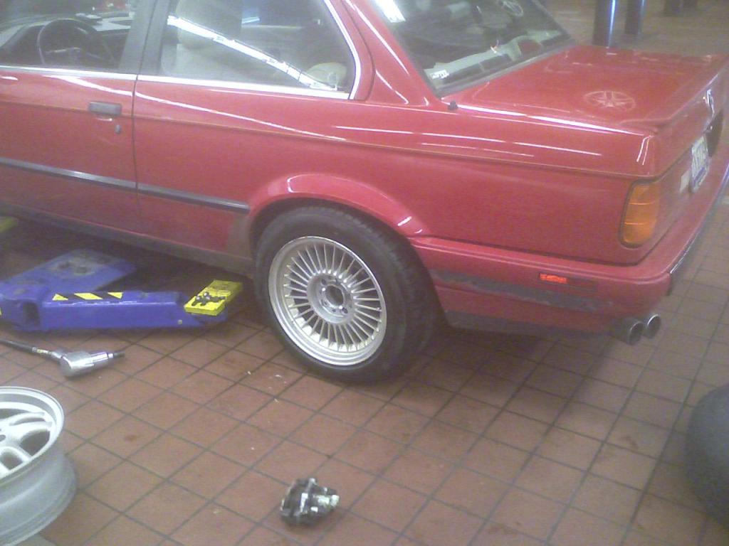

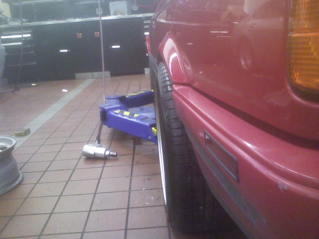

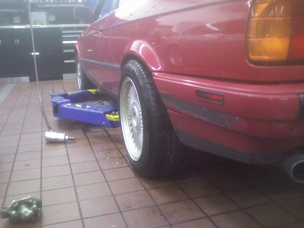

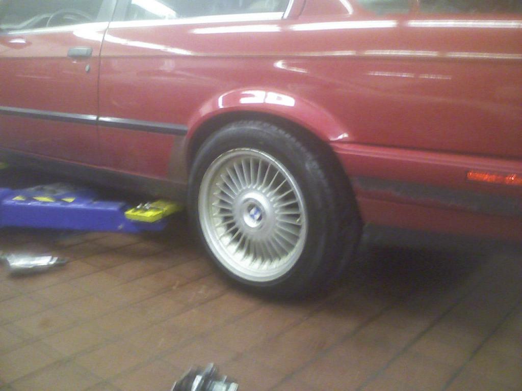

              ET23 test fit
              I put a 205/55R16 on this ET23 16" Rim from a 750il E38 and held it onto the car by bolting a z3 rotor to the rim and simply holding the rotor to the car with the caliper (still have the E30 hubs in there, but this was just to check fitment of this rim)
              they stick out quite a bit and it looked funny thats for sure.. but i dunno if they will still look funny when the fronts match the rear or what.. the look of a car with skinnys on the front and fatties on the rear is not cool at all, unless of course its a dragster or something..
              whattaya think?

                #52
                not bad, really not that bad.

                  #53
                  Really? Im getting mixed opinions on the look of it.. some say its awesome and some say it looks stupid as hell.. Im gonna just put them on and see how it looks and see if they even turn up front without hitting.. if i totally hate it ill take them off but i do wish i could get that wheel style on my car and make it fit right. these would work great on an E30 M3 suspension, wouldnt they?
                  • daniel
                    • 6703
                    #54
                    your first problem is your tires are too big. and for some reason the rears are definitely sticking out more than mine are, with the same offset and width.
                    they would work perfectly with an e30 m3 suspension.
