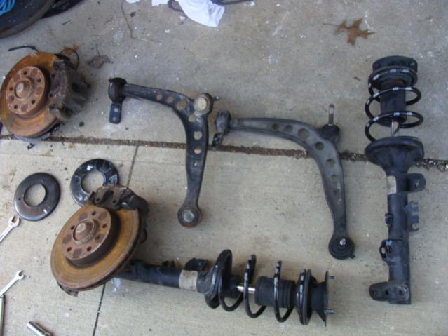

re-using e30 suspension on e36 5 lug swap
  • bimmer630
    • 1228
    i emailed the guy i bought them from.. he says they are the same except for offset upper bearings, but i looked up the strut #'s on BMW centernet and they are different.
    • bimmer630
      • 1228
      oh he hasnt shipped them yet, luckily. but i hope they will be compatible because i already paid him and he doesnt have any standard M3 struts in stock

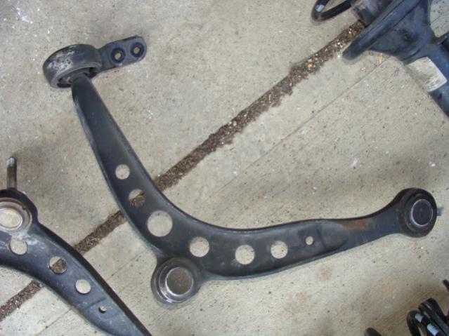

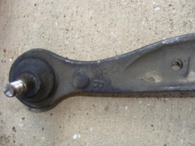

        Box-o-parts arrived today... Mroadster front struts and CA's. These arms look just like my E30 arms though! are these the correct M3 style arm to use? i cant find a part # on them but they one of them says 466 07 cdp.
        Wrong parts??

          I couldn't tell the difference until I had them side by side... So don't sweat it.
          • bimmer630
            • 1228
            yeah after looking at some online pics.. the arms do look the same. i guess its just a slight difference in the "bend" of the arm..
