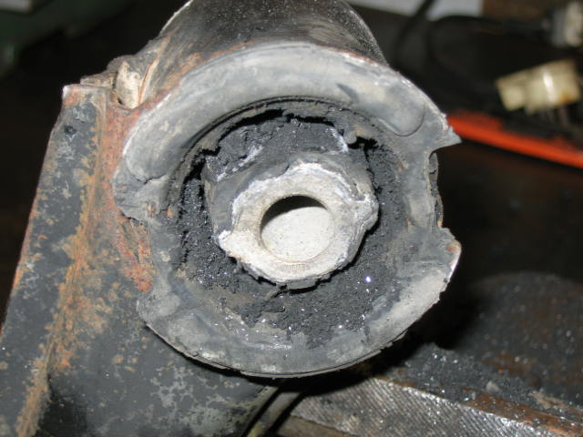

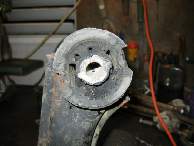

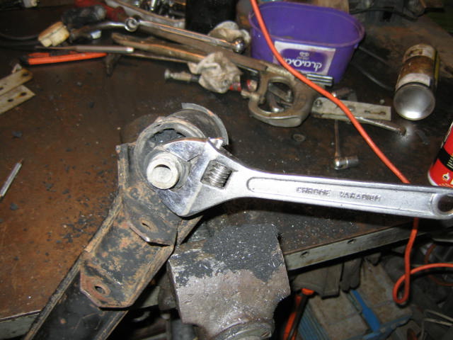

    Here's a way to remove the rear subframe bushes without using a gas torch or a puller:

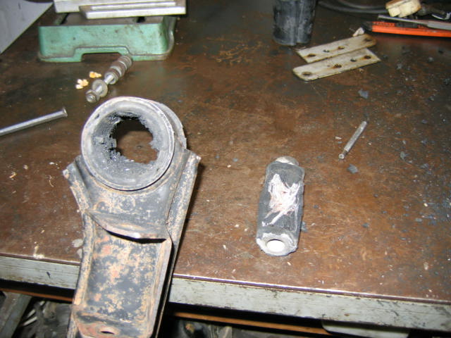

    1. Take a drill and attack the rubber parts of the bushing:
    2. Grab the center aluminium part of the bush , twist it and pull it out.

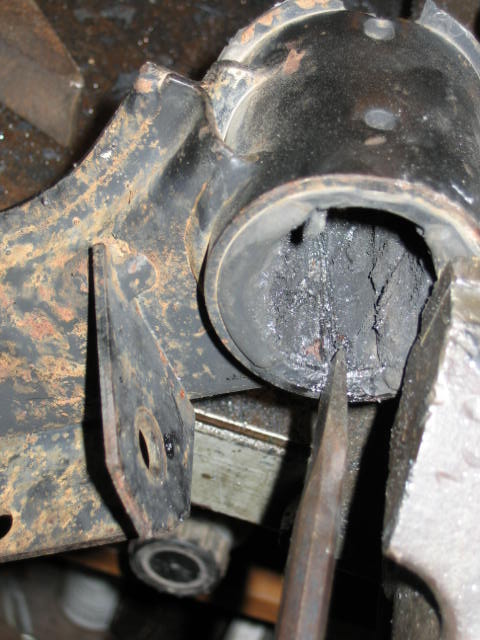

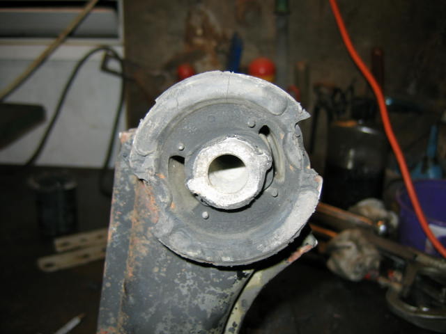

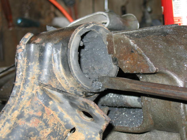

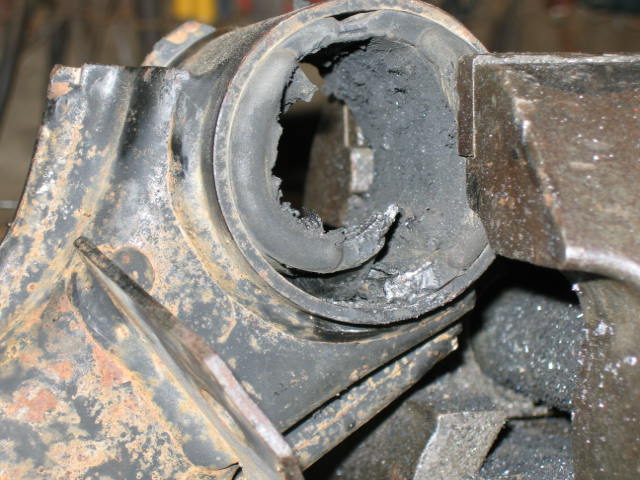

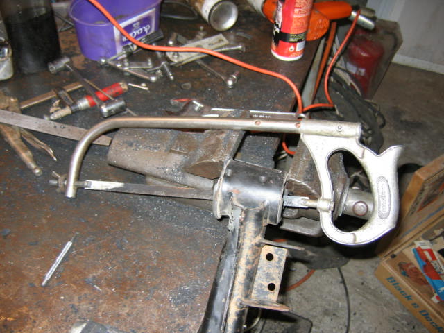

    3. Insert a hacksaw into the center of the bushing and cut a slot over the dimple part of the housing. Be careful to cut only the bushing, not the housing, the space over the dimples makes it easy.

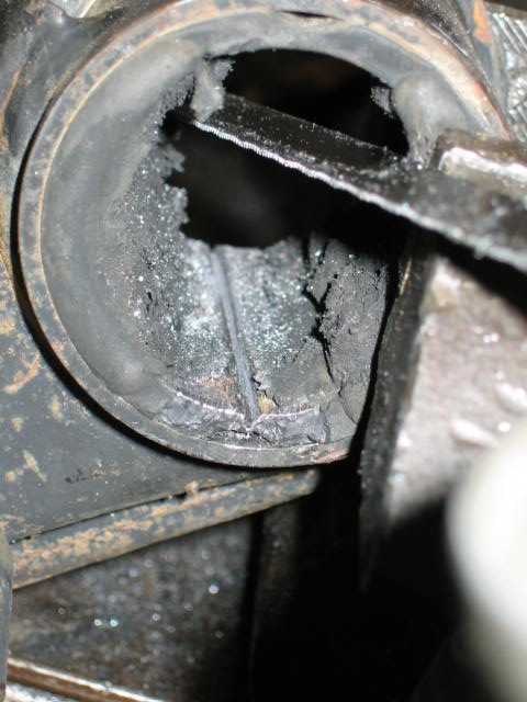

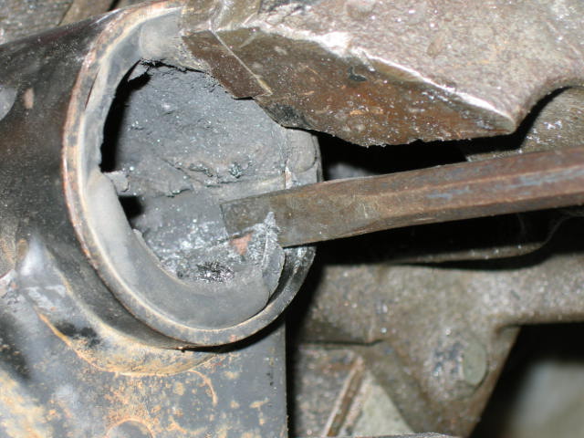

      4. Once the slot is cut all the way through the bush (you will fill slot in the bush "grabbing" the saw when neaing complition of the slot),use a chisel to push one edge of the slot over the other (for the entire length of the bushing).

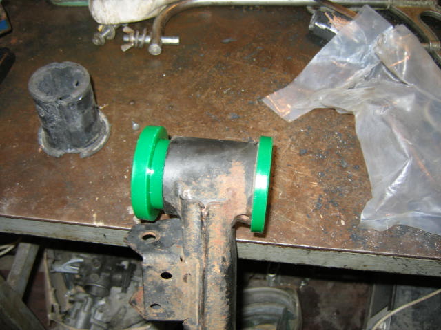

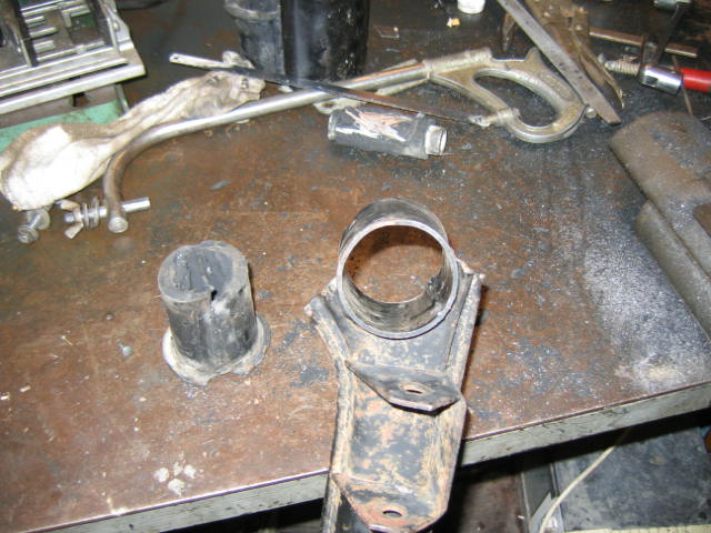

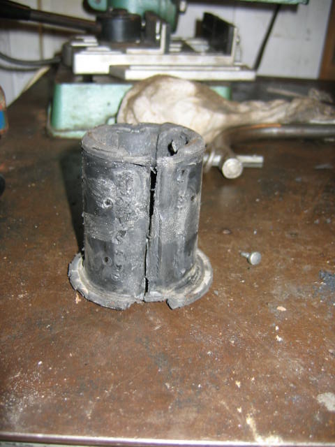

        5. Now the bushings's pressure is relieved. Place the subframe on a block of wood and tap the bushing out with a punch.
        6. Now you can fit the new bushing (trial fit in the picture).

          thats what i did. sucked balls
          • BahnE30
            • 1050
            i just air chiseled mine, no cutting nessecary, just folded it onto itself, and pushed it out the other side, took like 30 seconds per side, you guys have no idea what your missing using hand tools.......
            • Lair
              • Apr 2006
              • 1553
              Home Depot has an air chisel/hammer setup for $29. That's money well spent when you own a crusty old car.
              McCain's military draft: Are you willing to bet your life?
              • Garageaholic
                Freestyle Fabricator
                • Dec 2005
                • 5204
                That's exactly how I did mine. I used a sawzall instead of a hacksaw. worlds easier
