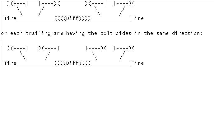

    I'm trying to figure out the orientation of the RTAB's I have from akg. They're the accentric models, with a hex nut for adjusting on one end.
    Anyone got a picture?
    I'm too greasy to bust out the camera, but this is my best guess, with the )( representing the side of the bushing with the hex nut. ie, all adjusters on the outside of each trailing arm:
    Crap my ascii art looked fine in the editor, making a screen shot, hold on
    Bueller?
    -josh
    Thanks dirtbleed, I went with option 1, actually looks like the only way they'll physically fit.
    The bushings themselves want to push out of trailing arms. I tighten them up and then they work back out. Maybe I put too much grease in there, and it's causing a problem.
    EDIT: IT WAS TOO MUCH GREASE, I GOT EM IN
