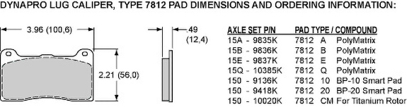

    Hey SkinnyVT. I guess it is you I met at Calabogie in July, right? Indeed the H compound is one of Wilwood's best kept secret if you run sticky tires (too much grip for street rubber). The H compound is a superb high friction pad, low wear endurance brake pad. It is not "officially" yet available for the Dynapro caliper, but can probably be cross referenced from another caliper. Check on www.rotorsandpads.com for compatibility.
