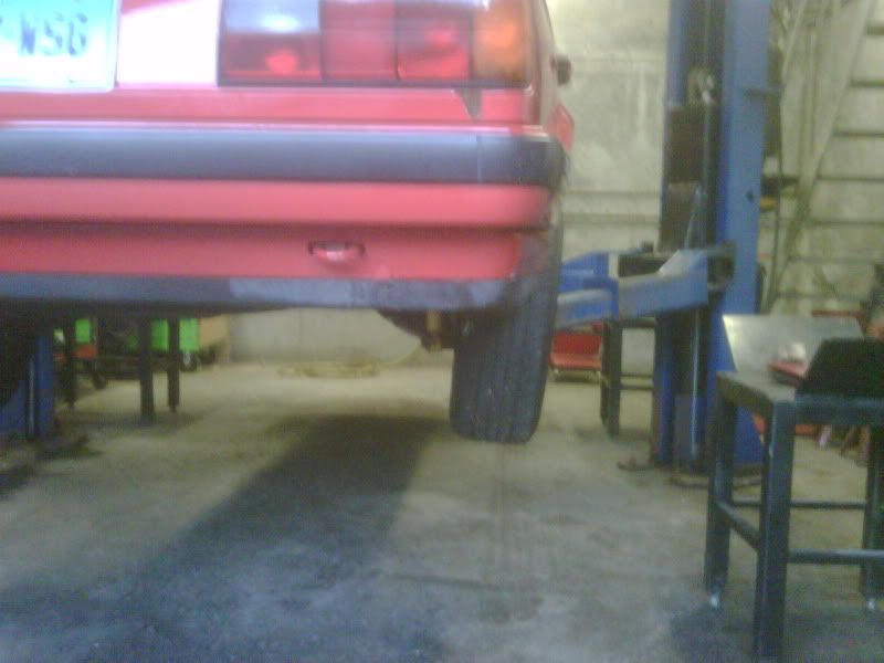

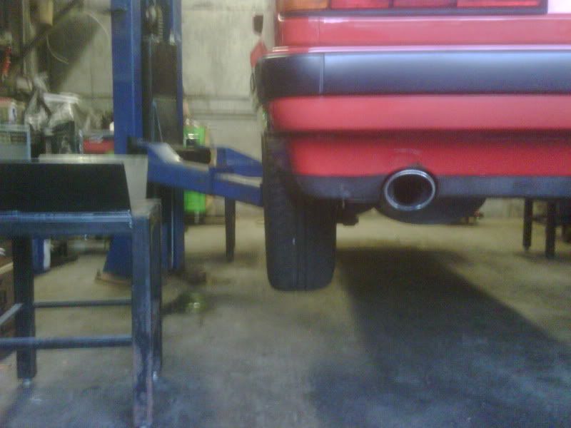

    so... im pretty upset about this...
    i let my frend take my e30 out for a spin the a couple weeks ago. long story short, he ended up smacking a curb on the passenger side with the rear leading in. cracked both basketweaves and snapped a tie rod. diff and axles are fine.
    now... the tie rod was replaced on now i have some basketweaves on the car on all 4 corners and got an alignment done in the front becasue we all know the rear is not adjustable.
    the front is perfectly fine, however... the back is completley whack! i have way too much neg camber on the driver side ( more than usual)and its almost a full degree difference postive on the passenger rear. city driving the car pulls to the right, 60+mph it pulls to the left. at first i thought maybe the passenger trailing arm was bent but now im skeptical as it may not be the problem.
    visually, there is nothing bent... the subframe looks fine, RTA's look fine... im puzzled
    heres some pics of the alignment. also of the camber on the rear wheels while its up on the lift. you can see the difference in camber.
    any ideas?
    -G

    Worn RTABs could easily explain the excessive negative camber on the driver's side. Especially if the car has aftermarket springs and a lower ride height.
    The problem with the passenger wheel is, at the least, a bent trailing arm. it may not look bent, but it is. The subframe could be bent, but that requires a huge hit and the chances of that being the case are very slight.
