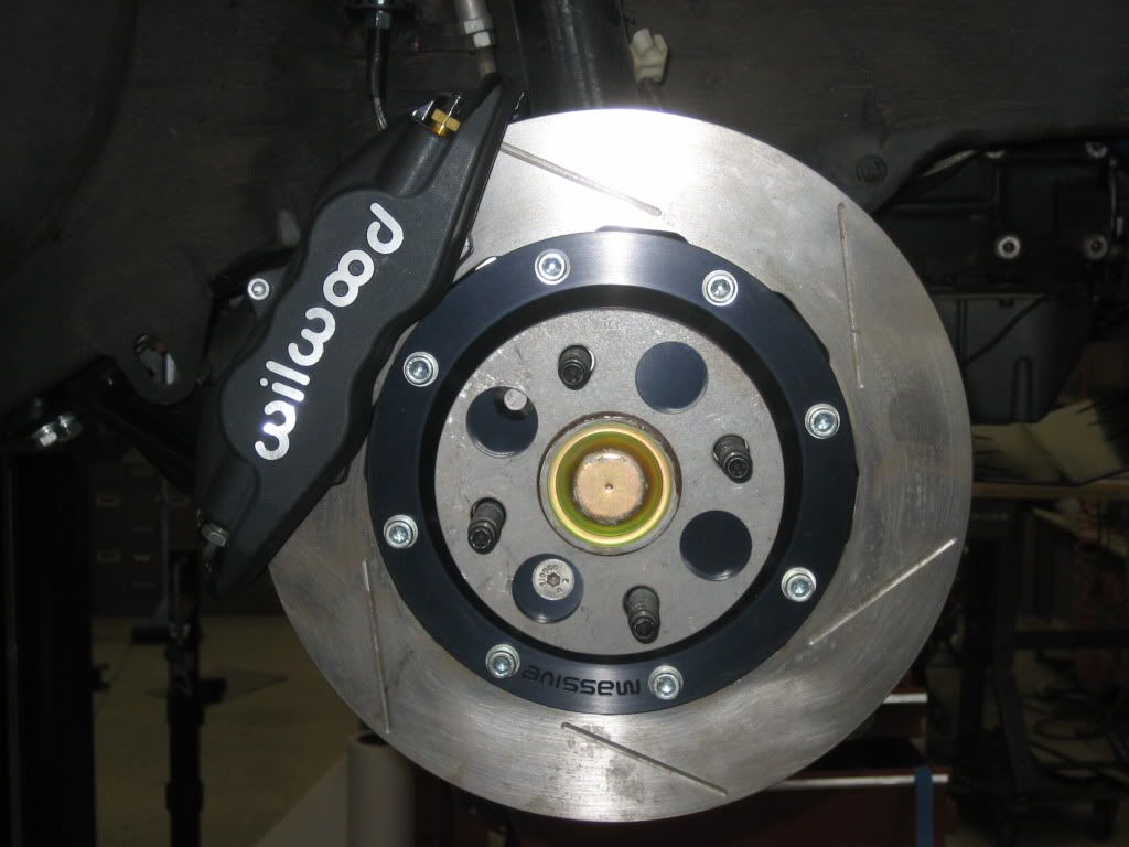

    Just installed my new brakes from Lee, they are incredible!
    Lee includes all the little things in his kit, even teflon tape, and a 1/4 wrench for the bleeding!
    Here are some pics:
    I needed 6mm spacers up front to clear my AC Snitzers.
    Thanks Lee! :pimp:

      Is this the 280mm kit?
        Front and rear? I bet that is fun :)
          300mm x 21mm front
          300mm x 32mm rear

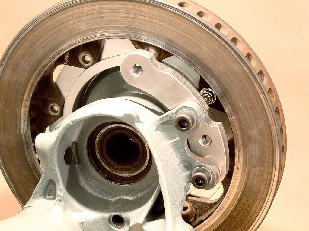

            Hey buddy. Thanks for the good word. But check the orientation of the discs. They are inversed. When spinning, the discs should act as a turbine, thanks to the directional vanes. The turbine sucks air from the center toward the outside perimeter. Also, the slots are designed to push the pads into the caliper, not "pull them out". But hey, it is a pretty common mistake. You're not the first and won't be the last... ;-)
            Also, for everyone's interest. I came to realize that German fine enginering and production capacities sometimes are not to the exact specs we expect. Per exemple, the castings of trailing arms will vary from one unit to the next. Specifically, the caliper's mounting ears are designed to fit very snugly between the trailing arms' mounting ears. I found in many cases, that no filing or grinding is required on either side, but sometimes one side may beg for some "help". Not much. Usually 0.5mm deep on a dime size area. Sometimes none of the trailing arms need help, sometimes both. Go figure.
            The bottom face of the upper mount might need filing.
              I had to do this on one side of my rear kit, it was a small amount of material removal and the fit was then perfect. The picture above doesn't really show the area as the bracket design (on my kit, anyways) was different. Lee's description of the area is spot on.

                Hi Brian
                The very first production of caliper brackets was as pictured aboved. Then, the following productions included and extra tab. This extra tab allows to cancellate any possible oscillation of the bracket while racers may elect to even tack weld the bottom tab. Were there some oscilation before? Not that I know. But I had the possibility to improve and ditch any theorical oscilation. So why not do it?
                    Lee,
                    I changed them the next day after the pictures were taken. (as a result of my original post in the fitment thread)
                    Thanks!
