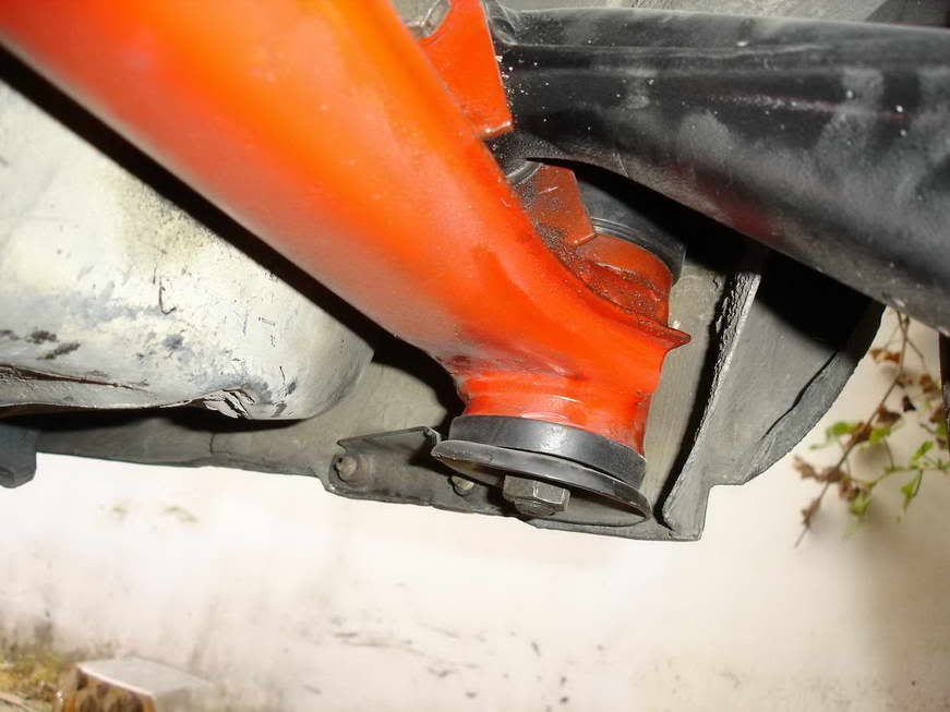

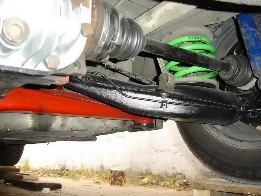

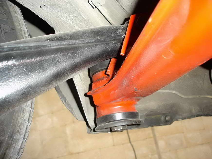

    Hi just did my rear subframe, had the car on Auto-X and after leaving the track i started to hear clank's from the rear end.
    i raised the car and could see that the right side of the subframe seats somewhat strange (see in the pictures)
    could it be that i installed the subframe wrong?
    the mounts are AKG 70D
    right side:
    left side:

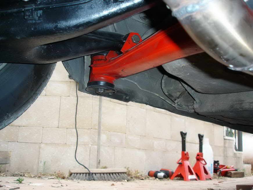

  • 325issguy
    • Dec 2005
    • 261
    Mine seems to have the same problem, not sure if its because I did not use the washers from the stock subframe bushings.
    • FredK
      • 14763
      70A or 75D?
      If you have the 70A, you need to reuse the washers.
      If you have the 75D, you do not need the washers.
