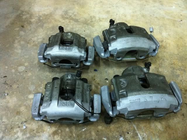

          However, at the end, I decided not to get them sand blasted. I just washed them down as best as I could. Then I painted them in the front to freshen them up a bit.
