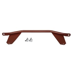

      I'm a little confused. How exactly does this mount? Is there a plate welded on at the end of the tubes with a hole in it?

          There is basically a slotted washer welded to the end of those tubes which a bolt goes through.

            Ok back on track! Brace is installed and works well, noticeably stiffens up the front end especially obvious when entering driveways with steep transitions. I used to be able to feel the whole front end flex as I slowly turned in now that is greatly reduced. Also feels more planted on hard cornering and over abrupt bumps.
            Fitment wise we already knew I had to shorten that one front tube mount. I cut it down and welded the washer back on. If I hadn't had a skid plate it would have bolted right up no problem (minus the welding which I knew had to be done) I just had to fineness the front of the brace and skid plate its snug in between the 2. Here are some pics of the ordeal.
            Marked for cutting
            cut to the right length
            ready to weld
            tigged back on
            painted with some white epoxy enamel and installed
            ground clearance reduction or lack there of. Shouldn't have any issues even if I ever get coilovers.
            side shot
            I tried to take a picture of how tight it is between the back of the skid plate and the front mounts but the car was too close to the ground to fit the camera in there well.
            Overall if they fix the MFG defect the product will be a nice affordable piece that works as it should.
