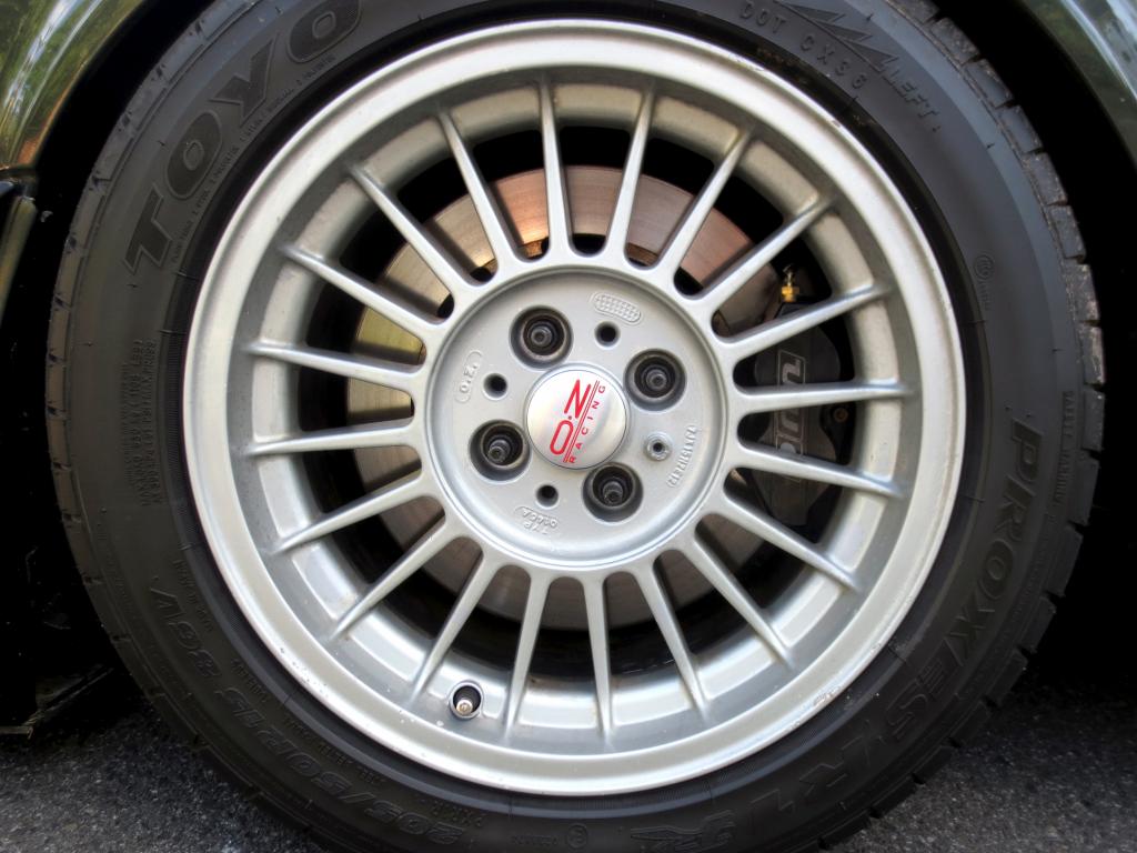

              So I've found out 2piece 15" Oz turbos won't fit without minimum 10mm spacer (maybe)
              15x7 +12 Oz "alpinas" do fit according to a seller that tested the template for me.
              I really hope he measured them right because I bought them! So ill post some pics when its all said and done..

                              #44
                              Well I mentioned this earlier in the thread. But now they are fitted i can say that OZ racing Type 146A (Commonly referred to as OZ Alpinas) will fit with a 3mm spacer. They are super close though, so you may want a 5mm but you 100% would need to roll your guards if lowered and using 205's.
                              They are 15x7, +12
                              Tyres are 205-50-15, TOYO R1R.
                              3mm spacer up front.
