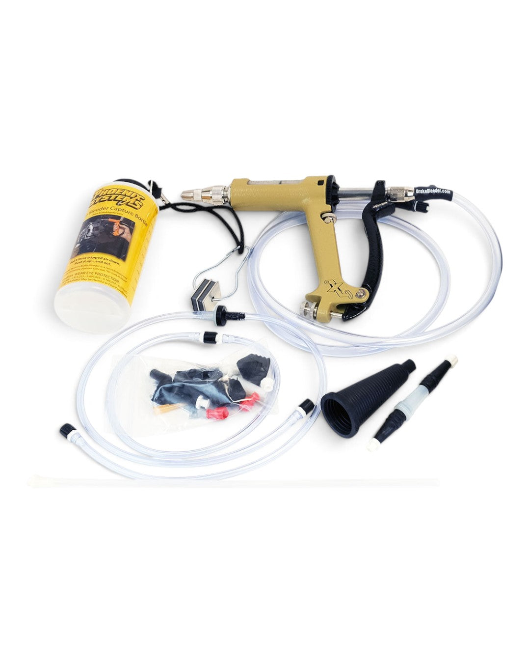

                  • Aahj
                    • Nov 2011
                    • 84
                    I use this to flush/bleed my brakes. Best tool I've used hands down:
                    The MaxProHD  Brake Bleeder is considered a lifetime tool by the countless ASE Certified Mechanics who use it to bleed brake and clutch systems daily. The hand pump is made of cast Aluminum Alloy, has a brake fluid resistant powder-coating, and is fully rebuildable. As a bonus you will also receive a 2-year warranty an
