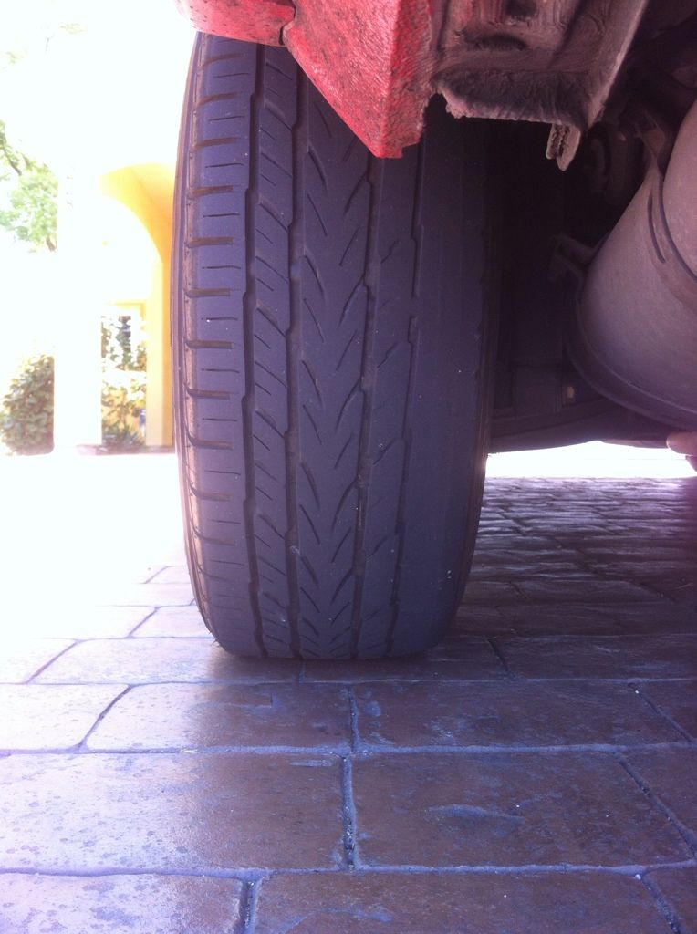

    I believe it's the trailing arm bushings, is this wrong? Both the rear tires on the red e30 vert are worn almost identically on the inner 1-2". They're bald there and almost new on the outside.

            Nope, stock springs. Maybe a bit saggy after 130k, but not nearly enough camber to cause that. Looks basically like post 4.

                Here's pics. I believe it's the trailing arm, maybe the subframe bushings. Would this be correct?
                Not low at all...

                    Worn rtabs can cause that. Have you had the car on an alignment rack and gotten the numbers for rear amber & toe. That will tell if there are problems with the rear alignment.

                      Rtabs, not subframe.
                      Static alignment will probably spec out fine, but the bushings are soft/worn enough that when you put load on the suspension they deflect well past spec and cause the wear you see.

                        Awesome, just what I wanted to hear. Gonna do this all the 4th of july week.
