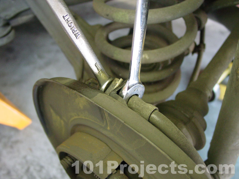

    After recently ruining my rear passenger dust shield from using a hub removal tool incorrectly (I know, I know...), I will need to replace the entire dust shield. I looked behind my damaged one to see how to remove it, it appears that the brake line screws into a bracket connected to the dust shield. Unfortunately I don't have the necessary tools to bleed brake lines - so does anyone have any ideas as to how to keep the assembly somewhat together without having to open any of the brake lines up?
    Here's a picture taken from Pelican Parts that shows the spot I'm having issues with:
    The more I think about this, the less possible it seems. If I understand the process correctly, I would loosen these fittings above, put on my new dust shield, connect the hoses again and bleed the line from the caliper end of the hose?
    Thanks!

    Yes, that mount the lines couple through is secured to the backing plate. They must come off and be secured to the new one. The good news is, the only special tool you need to bleed the brakes is a friend with a functional right foot.

      Good to know! Thank you for the reply. Is this just a standard procedure for bleeding brakes?
          ^ You already got it figured out. If you are unclear on how to bleed the brakes, just search YouTube. It's more than simple. You'll need a buddy, small hose to fit over bleeder screw nipple (clear is best), small bottle/container, and a wrench small enough to open/close the bleeder screw/valve.
