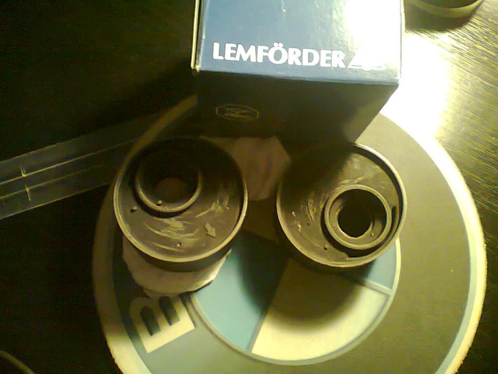

    I bought this bushings and i want to know if I put on my E30 325i will be any improvement?

    yes, there will be a bit of an improvement at higher speeds. Make sure to get a new allgnment after they are installed.

        They will push the wheels further forward and change caster. It's a very common upgrade.

          Those bushings will increase caster, which will make the car a bit more stable at high speeds. That is the only affect.

              Another small benefit is that the M3 bushing will deform less under load.
              You can see here the stock E30 bushings have voids in the rubber, the M3 bushing is almost entirely filled with rubber.
