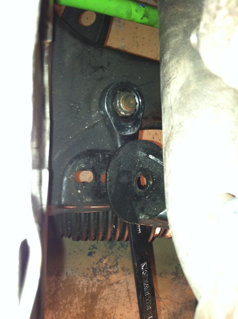

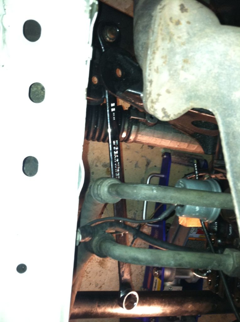

                • iwantspeed
                  • 3164
                  If you jack up the engine with a 2x4 and a floor jack on the oil pan just to support the weight of the engine. You can remove the engine mounts and fit a wrench in there.
                  In my case I had to place a second floor jack on control to keep the bolt from spinning.
                  Another issue I had is once I got the nut loose the tapered part of the control arm would not let go from the subframe. I had to use a big fucking hammer and an extension to beat down on The control arm bolt.
