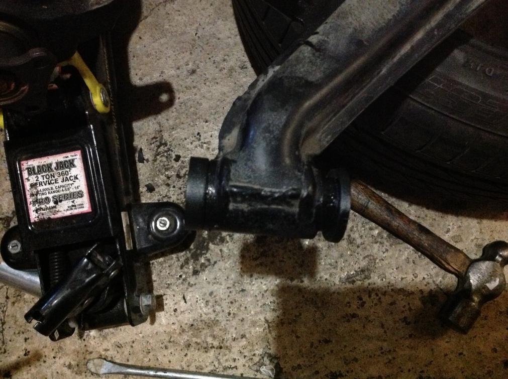

    I'm currently swapping out my rear subframe and rta bushings. Everything (mostly everything) was going smooth. Until I attempted to install the rtab. I'm using an AKG tool. The problem is I can't get the bushings to sit properly into the arms.
    Wen installing I followed this procedure. http://www.akgmotorsport.com/rtabremove.html
    Àny help would be very appreciated. I'm in a pinch!
    Here's is the pic.

    Did you lubricate it before installation?

      Yes lots of the lubricant.
      I've been reading that this is a "common" issue with IE RTABs? It starts to fold in on itself aswell with too much force from the tool.

        Been there, done that and not just with IE bushings. My solution was to lube the bushings with liquid soap and press them in. Wait a few days for the soap to dry (heat helps). Then lube the sleeves with synthetic grease and press them in. The dried soap helps to prevent the bushings from moving under the force of the sleeve being pressed in.

          Thanks. I think that will work.
          Any thoughts on how to remove this one for reinstall? Without damaging the bushing?

            Press out the sleeve. Then the bushings will come out pretty easily.

              ^Got it done! Thanks a lot for the help.
              I made a makeshift press out of a copper pipe and a threaded rod and the sleeves came out pretty easy.
