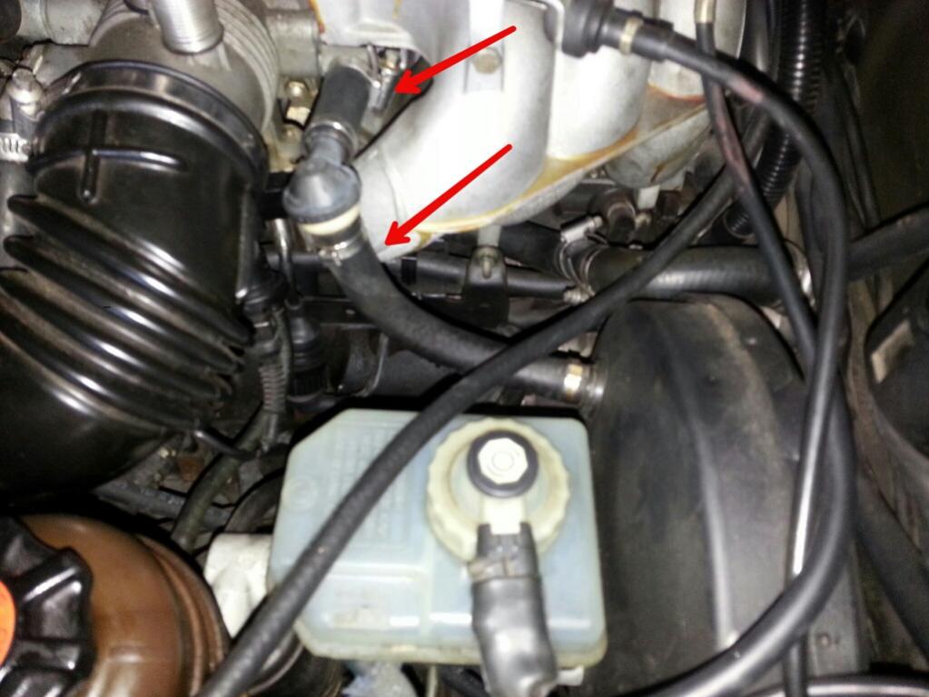

                  If I want to check vacuum pressure related to the booster where should I check it & what should it be?
                  I figured check before & after the check valve. The Bentley manual says to take the valve out and blow through it too. Can I check something on/after the booster? And again what should the vacuum pressure be?
                  btw, the PO put in cross drilled rotors, SS lines, new calipers (not sure what kind), along with the 735i MC & Booster.

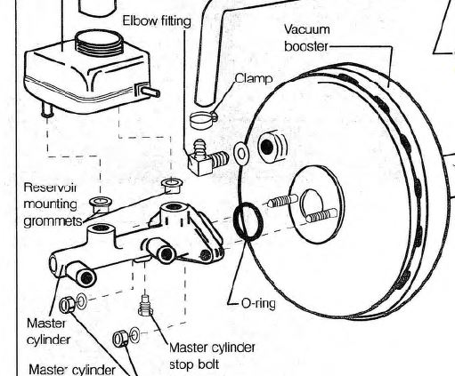

                    So I ordered a vacuum booster from a fellow r3vster. Last night in preparation for its arrival I pulled out the master cylinder. Low & behold there was no o-ring between the MC & booster. As the Bentley manual says: "A faulty O-ring can be the source of a vacuum leak, causing a reduction in braking performance or an erratic idle speed." I would say no o-ring = vacuum leak = poor braking performance. Thanks PO ;D
                    Ran down to o'rielly and picked up an o-ring, will re-install tonight but I'm pretty sure that's it!
