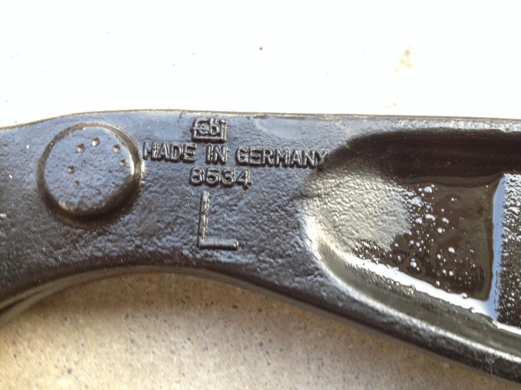

                            I bought the Febi control arm from Pelican Parts since it's only 20 minutes away. I always trust Pelican, but sometimes I like that magazine that Bavauto gives, lol. But I think I made the right decision at $70.
                            • nickmcc92
                              • Dec 2012
                              • 442
                              Made in Germany :)
