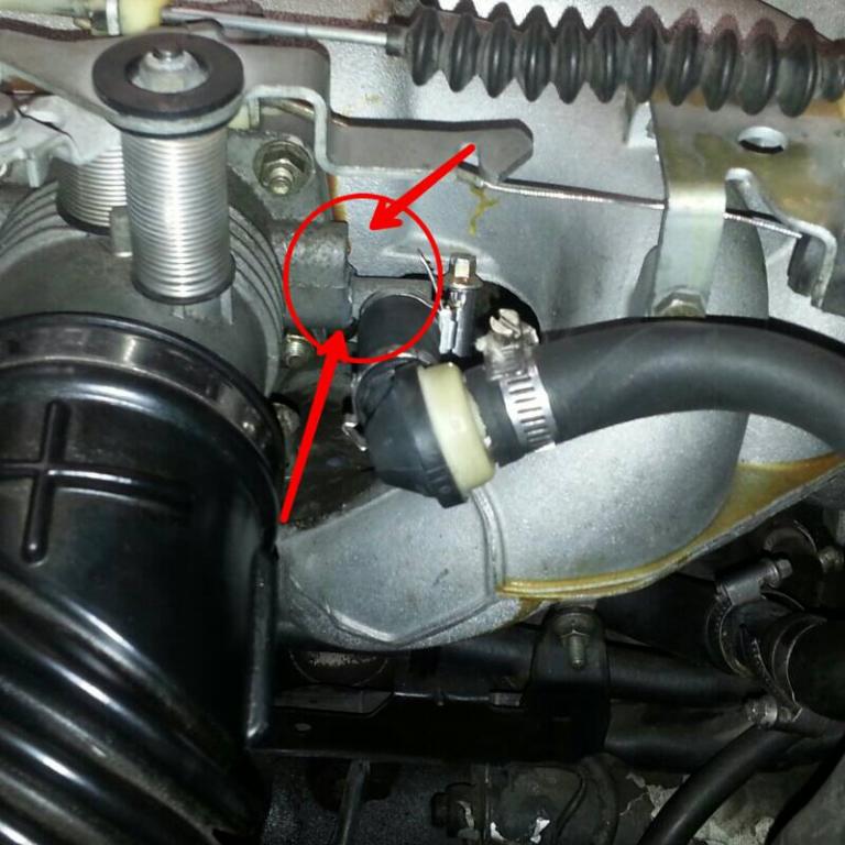

    I'm trying to troubleshoot a braking problem. Does this check valve look correct? Realoem shows one in from the booster and 2 out to the manifold. Mine only has one in and one out, leaving a fitting open on the manifold.
    Just wondering if I'm not getting vacuum assist because of this.

    BMW used two systems for the vacuum hose. One is the single connect, like you have and the other is a dual connect.
    No vacuum boost, especially with the engine idling, will be a major leak between the intake and the booster or a bad booster.
