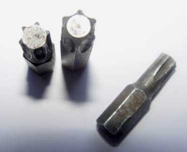

              You could also just use a star drive that's a bit larger than the hex, pound it in with a hammer, then ratchet or wrench it out. Quite a bit simpler in my opinion.
