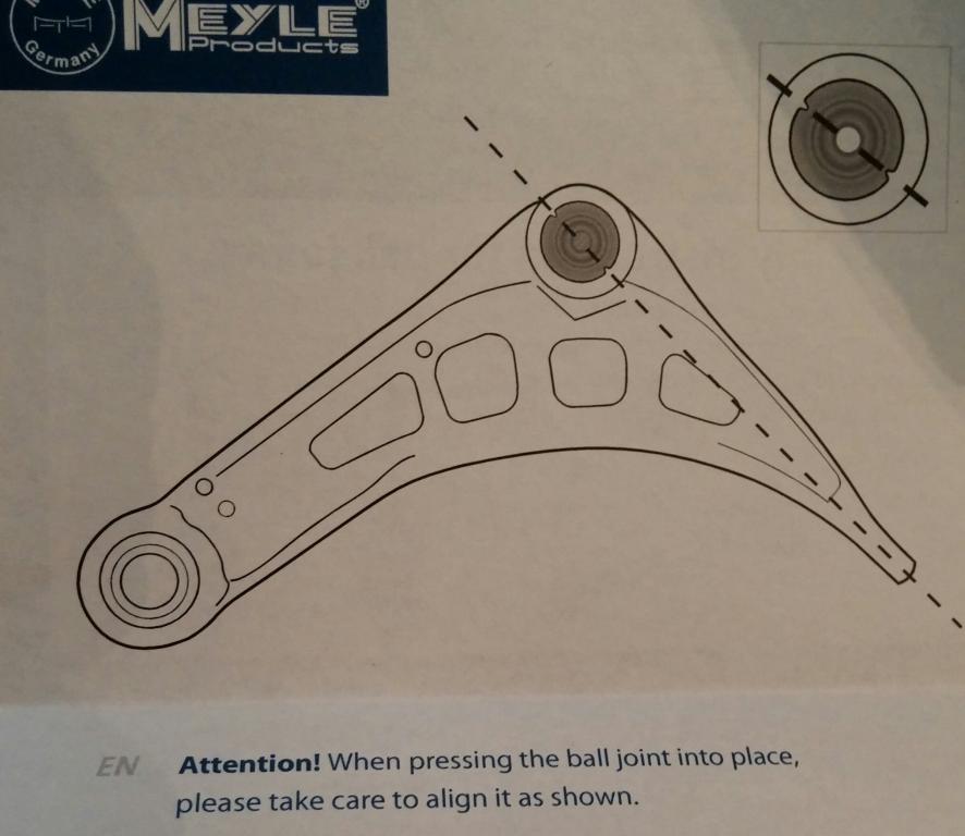

    Ball joint orientation
    Replacing the ball joints in my control arms, had a stupid attack and forgot to mark the orientation of the notches on the old joints. The replacement inner ball joints came with a diagram but the outer joints didn't. Does it matter how the outer joints are oriented? Thanks

      If you've got a 20ton press it's really easy, just mark where the notches are on the old ones before starting.
