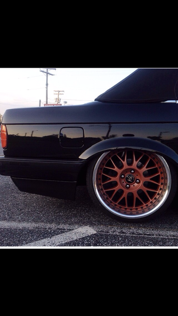

    rear toe measurement
    quick background first.. i have an e30 vert on airride, my rear wheels tuck, alot, but i need about 1/4" more clearance to get the wheels to tuck as much as i want (want the car lower) my wheel lips hit inside the wheel arches ALMOST far enough to tuck completely into the body..
    to get that last 1/4-3/8" i was planning on adding a little more camber in the back, but if i can avoid it id like to..
    has anyone thats used the eccentric bolts to fix the toe actually measured how much the track width narrowed from it? id imagine it would be atleast that much to get the wheel straight again
    to answer potential questions, i do not want to change my wheels.. i cannot pull the body to clear anymore, and i cannot mill the wheel flange down any for clearance..
    thanks..

    Correcting the toe will have a very minimal effect on the track width... I use the eccentrics on my spec e30.

      guess im gonna have to add a little camber then also.. thanks
