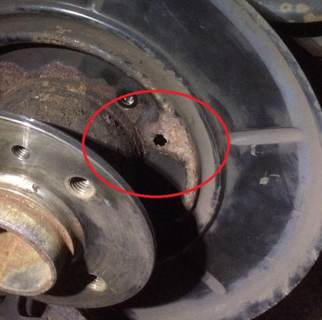

I noticed some light metallic scraping sounds yesterday, increasing frequency with vehicle speed, but not engine rpm. after lightly pulling the e-brake it was clear it was an issue with the e-brake somewhere.
Today it got progressively worse (embarrassed to drive in public type of sounds).
I took the brake disk off and found the ebrake spring/pin rattling around in the inner drum of the rotor. Step 1 complete, found the source.
Bad news is that the hole that this pin locates in is rotted and rusted, which is why it fell out to begin with.
I would love to replace the dust shield with brand new shiny parts, but it turns out I will need to replace the hub bearings, and the brake lines that are pretty rusty (and I JUST bled new fluid 2 days ago) so I would rather not go down that long, dark, expensive road.
Any ideas on how to get the pin to stay? I read a thread elsewhere about using a washer, but not sure how that will work since you need the hole to be obround (to slide in and rotate to lock).
