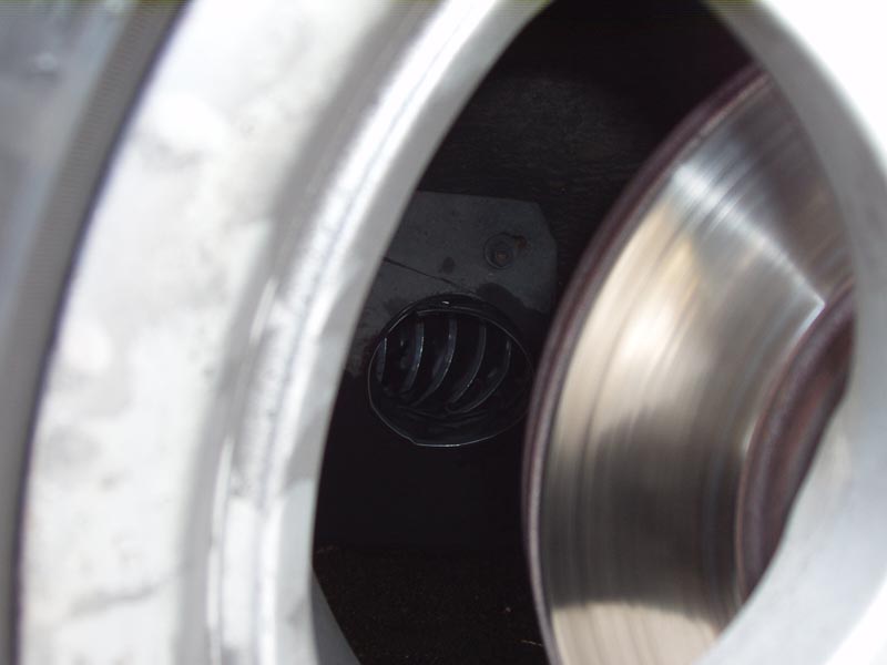

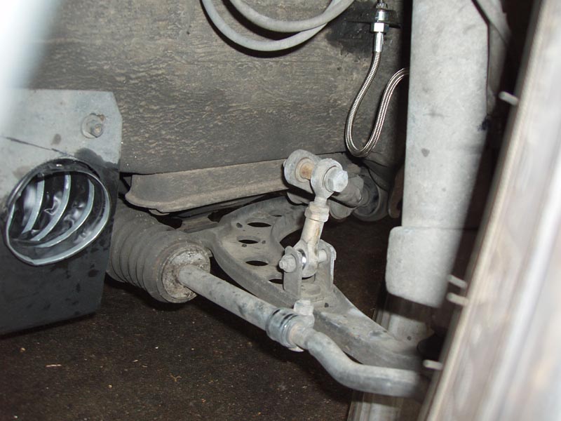

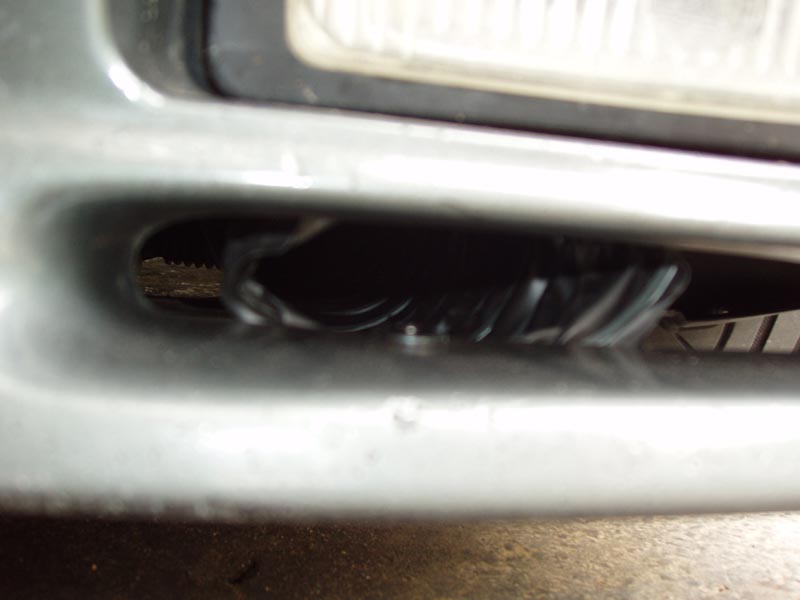

          For mainly a street driven car, you dont want backing plates. Brakes need heat to operate properly, especially if you are using high performance pads.
          If you want to have a complete setup w/ backing plates for when you go to the track, have a coupler so you can remove part of the hose for the street.
          The attached pics are something I cooked up in 30 minutes - I plan to improve it in the future. The coupler will be right where the hose exits the plastic fender well liner. The hose is attached to the bottom side opening in the 87 IS valence with pop rivets.
          My setup is actually quite effective since it doubled the amount of stops I had to make before my HAWK hp+ started working (the control is the same daily commute).
