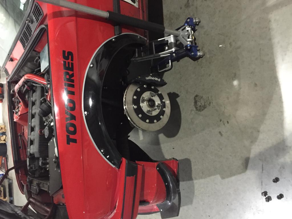

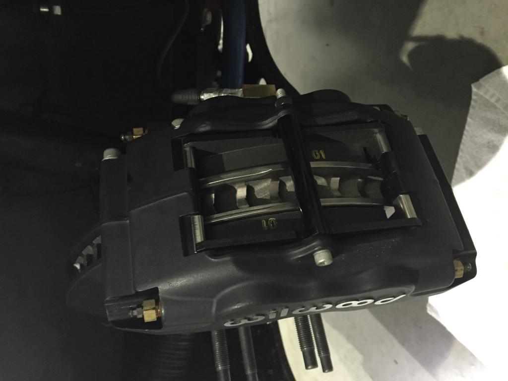

        My friend, I have been using UUC for couple year for my track days, and it was OK until I started to do ''wheel to wheel'' racing with my S50 swapped E30. These brakes are garbage. I was blowing seals twice a weekend. What I did now, I contacted Lee at Massive and he built me monster set up, 332mm front brakes with Wilwood calipers and rotors. Now I run PFC01 pads and brakes are just awesome. I would recommend you this set up. It saved me bunch of money as I did not needed to switch to 5 lug set up to find good brakes.

          Here is a pic

            Another one. Look at the thicknes of that disc and pads 😄
