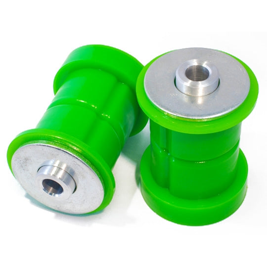

    Our solid 12mm rear subframe riser bushings are designed to extend the life of your rear tires. These E30 subframe rise bushings are made with UHMW material.
    This is what I used. The material from the bushing is moved so that the subframe can tuck closer in. The kit includes the spaces and hardware. I have the spacers and hardware if you go a different route though.

      I used revshift.
      http://www.revshift.com/product-p/psb-e30.htm

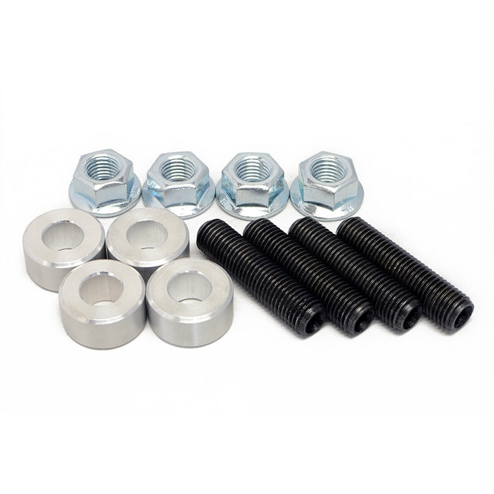

      Remember, when you raise the rear subframe 12mm, you should drop the differential 12mm to keep the drive shaft to pinion angle the same as factory. There is a option to include the kit for a little extra.
      This is the kit, separate from the bushings.
      http://www.revshift.com/product-p/dss-12.htm

        I was going to slot the rear diff mount to raise the rear of the diff to keep the pinion angle the same, or is there not enough clearance?
        Otherwise I can see why dropping the front would be worthwhile.
        Thanks for the replies.
        • wworm
          • Dec 2016
          • 1719
          you need to lower the diff, not raise it. The spacers are required to space the diff down off the subframe to keep it in the same spot as before. Slotting the diff bushing will just allow you to bolt the diff directly to the subframe (without spacers) which will put your driveline at a different angle than factory
