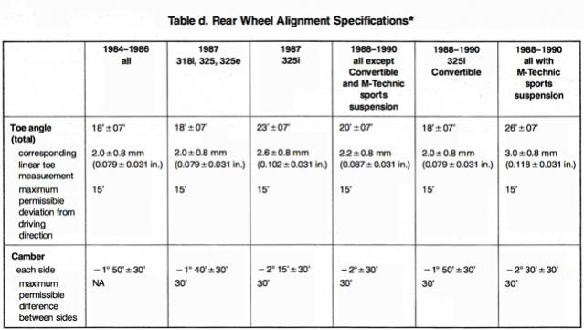

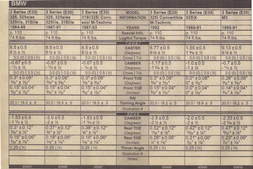

    Rear Alignment stock settings?
    I'm having the alignment shop check for a bent rear trailing arm. I should ask for toe and camber?
    He'll tell me those aren't adjustable and he can't do it - I'll say I just want them measured.
    I don't have the Bentley with me - are these correct numbers? It's an '86 es coupe.
    Thanks -

    Camber Rear -
    Left: -2.79ยบ
    Right: -2.68 (so a hair over the spec max of -2.33, but it's lowered on ET15 wheels)
    Toe Rear -
    Left: .42
    Right: .61 (spec range is .09 to .22)
    Total: 1.03
    Thrust Angle: .10

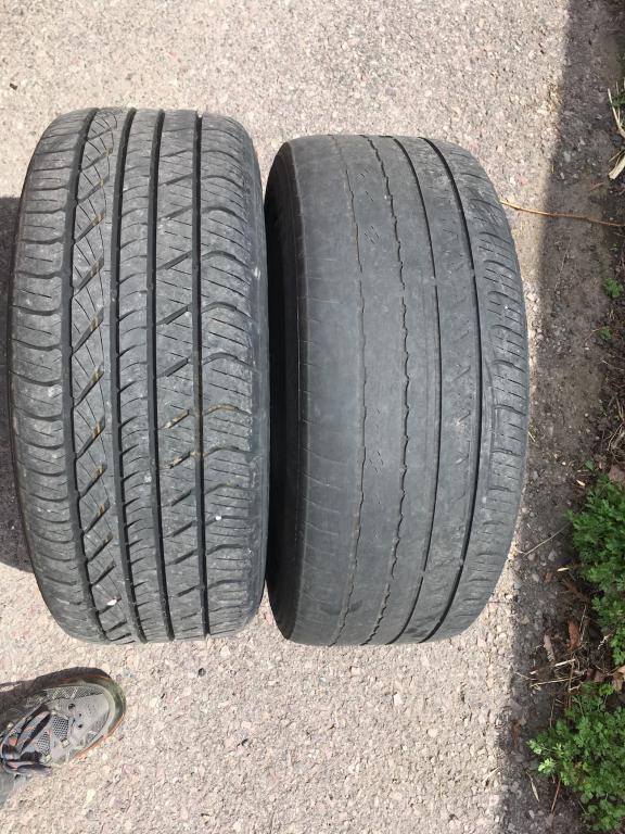

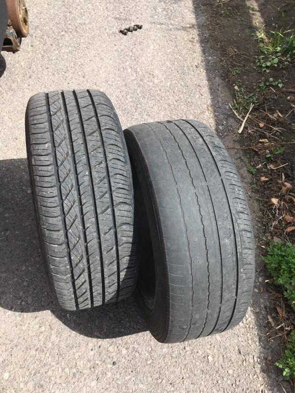

      RF & RR with 10,000 miles or less on them. The fronts look nearly new.
      Not sticky summer tires, these are Kuhmo all-seasons.
      It's an eta automatic, it ain't breaking the rears loose. His roommate didn't steal it to go drifting.
      We want a solid DD that handles well and looks good. I'm frustrated and pissed.
