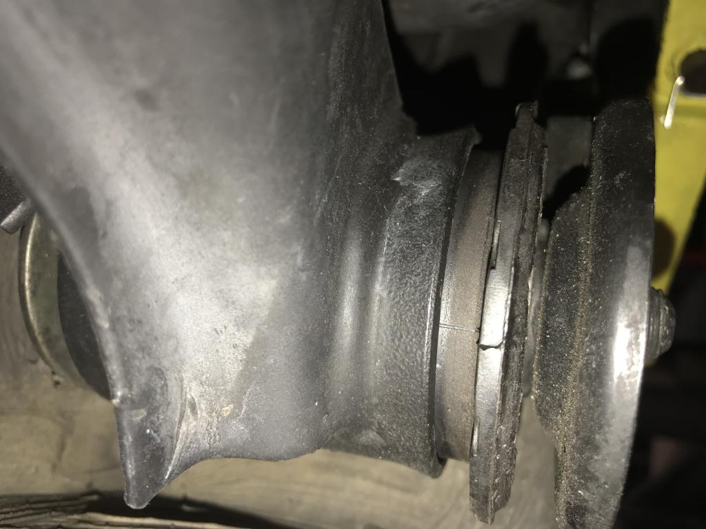

    I'm having some issues with the subframe bushings on my 88 325is.
    The bushing on the driver side gets pushed out by about 1/4 inch after driving a while, resulting in the driver side rear being 1/4 lower.
    Brand new bushing(OEM rubber), correctly pressed in all the way(100% sure since this is the second time this is happening )
    Any idea what could cause that? Bent subframe? Any prior collision that bent the body?
    Thank you!

      really? The car rides 1/4" lower in that corner than everywhere else, I can't believe that that's normal?

        My bad. Was looking at the wrong gap.
