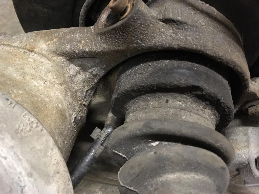

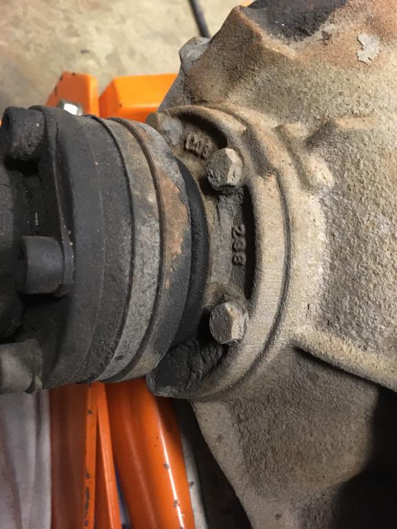

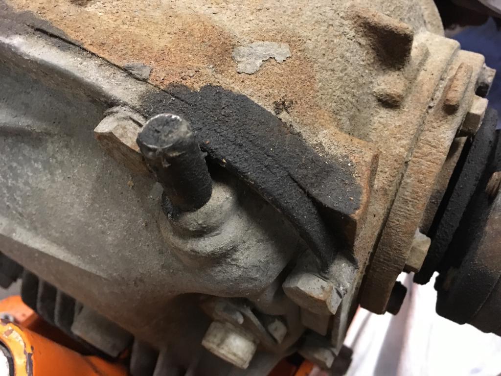

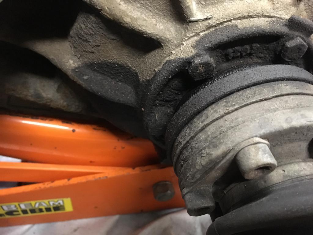

    While we have the subframe out and cleaning things up, I have some questions. Are these normal looking as far as oil leakage and grime? Are there seals we should change now or not worry? '86 ES, 175k miles.
    Diff seal left..

    Diff seal right..

    Is this a Diff vent? Just clean it?

    Axle hub right..

    For 30+ yrs and 175k it looks pretty normal to me. Still, seals are cheap and easy, so while you’re in there you might as well...
