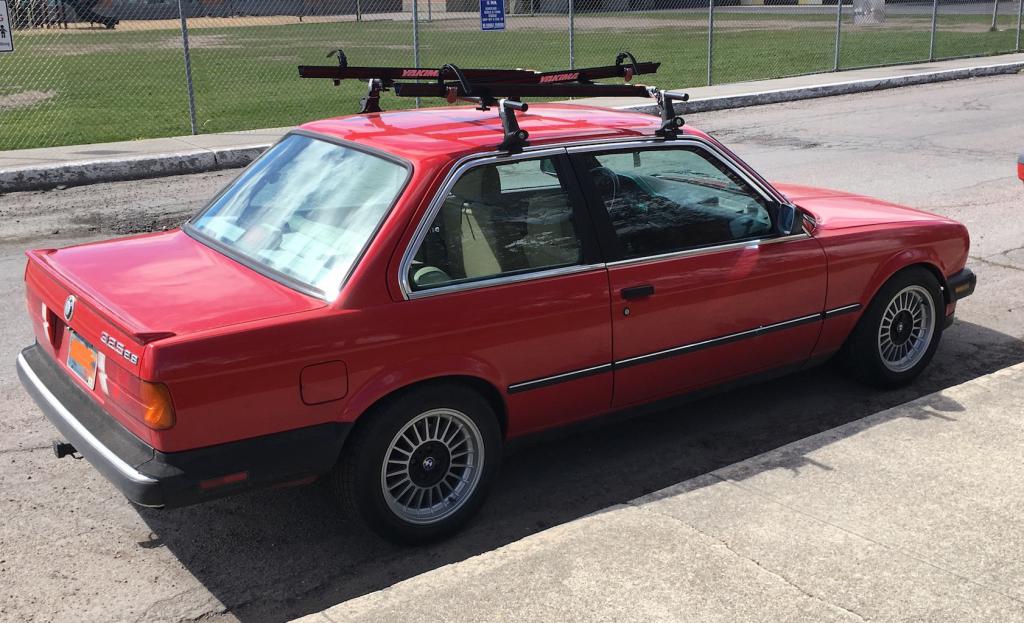

    We're heading for rear alignment Tues after welding in IE adjustable tabs kits and reinstalling the subframe. Arms are about centered in the slots just to drive it there, and not torqued.
    It's an '86 ES, DD street car, H&R Sport springs, front drop hats, 15x7 wheels ET12.

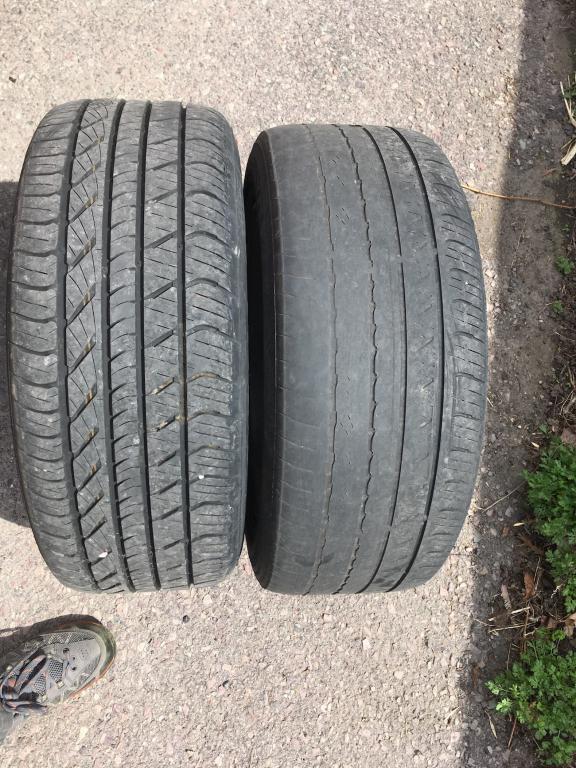

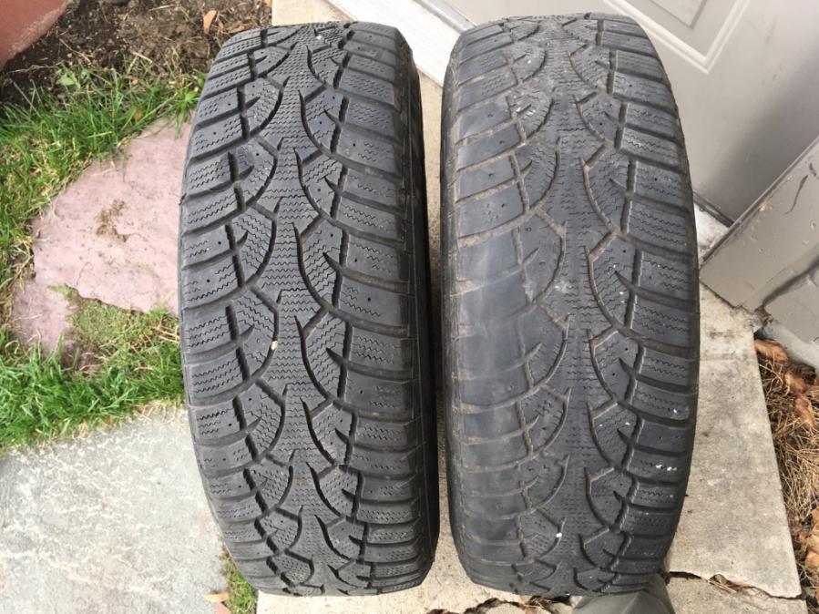

    It isn't very low. We want decent road handling and above all to not eat tires like it's doing.

    Before we pulled the subframe again the #s were:
    LR toe: .42º ( I assume these are toe-IN?)
    RR toe: .61º
    LR camber: -2.79º
    RR camber: -2.68º
    Thanks -
