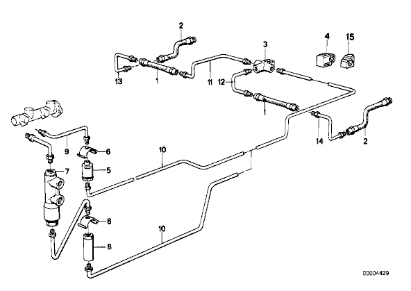

      Alright, where is one located on a stock e30 ?

        I believe the stock one is located towards the rear of the engine compartment, on the driver's side, where the hardline from the ABS unit that goes towards the rear brakes meets up with the hardline that runs underneath the car. It is part 5 in the attached diagram.

          Thanks, I take it all i'll need to do is replace it with a 325i pn # ?

            Yes, #5 is for the car you have I believe. The #8 one is for eairlier cars. Double check though.

              I looked at realoem.com and the brake pressure regulator is listed as the same PN for both an early 318i and newer 325i. It is not listing, however, PN for the item # 8 at all ?

                    I checked almost every permutation of E30. Part 8 does not exist for any of them.
                    However, what I did find is that the 318i (M10) uses the same proportioning valve as the 325e, 325i, 325ix, M3, 318is (M42). So, you should be safe in using the same proportioning valve.
