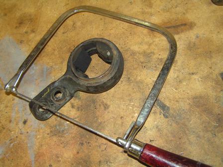

              Just in case you don't have an airsaw, I used a coping saw and cut through both sides of each bushing like butter. You can buy them at Home Depot or such for cheap. In case you don't know what a coping saw is, I've included a pic.
              Here's a great DIY on making your own CAB removal/install tool: http://www.understeer.com/lcab.shtml
