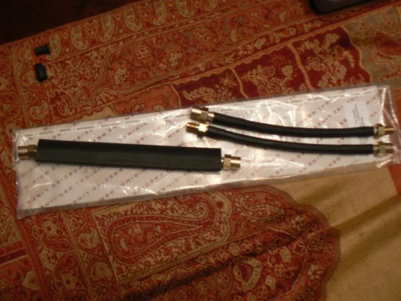

I decided to put heatshrink around the SS lines (got the lines from Turner) just for some extra protection.
I ordered 7ft (have ~2ft left over) of HS3-075FT, http://cableorganizer.com/heat-shrink/heat-shrink3.htm, (3:1 shrink - 3/4" to 1/4" shrink) from cableorganizer.com. The size is perfect, they shipped quick, and I'm very happy with the quality.
Who knows if it will help, but it will give me a little more piece of mind.
If you don't have a heat gun then don't bother because nothing else will work. My gun gets to 900F and it did well, but a hair dryer didn't hardly touch the stuff.
Sorry for the blurry picture.
