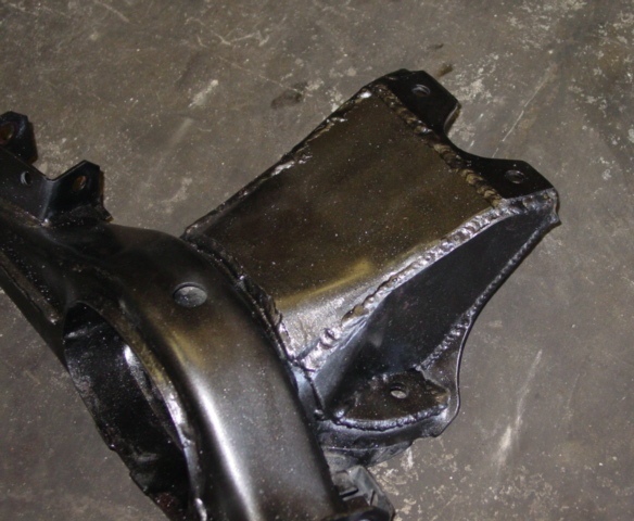

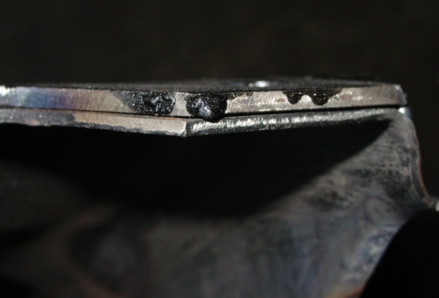

    The welds didn't turn out as cleanly as I had hoped, but... They will do the trick.
    The metal across the entire mount is now over double the thickness, and is also welded to the frame through the access holes underneath.

      I've had 1 bolt come out on my pos 318! No damage to the subframe though lol.
      That looks overkill, good!

        That looks pretty nice. If you haven't put it in yet, drill four or five 3/8 to 1/2" holes spaced out in the middle of the double layer plates and fill them with weld. The double layering is great but it will be over twice as strong if it is welded at several places in the middle as well as the edges. And I'm not sure where the second pic is, but run a bead over that crack!

          Holy overkill batman!
          I don't think you'll have another problem.
