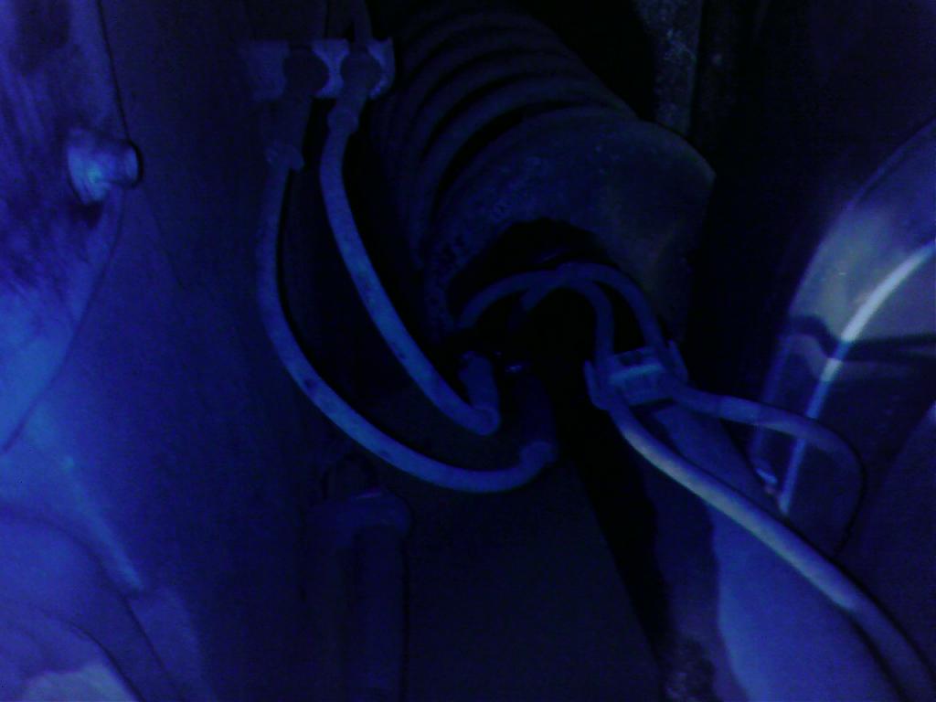

    so i was changing my oil today and found this. i think it has to do with my ABS stuff but u couldent find it in my bently manuel. the two lines seem to be leaking where they are attatched to the strut. can anyone tell me what this is? sorry about the crappy cell phone pic

    crappy pic but are your brakes spongy? If so you have a leaking soft brake line or a leaking strut.
    • Teaguer
      • Sep 2004
      • 6167
      Both of those are cables , not fluid lines .
      One is the brake pad wear sensor cable ...and it goes to the sendor in the caliper .
      The other is the abs sensor cable .....and it goes into the back of the strut knuckle/spindle .
      Thats really the only one that would/could leak .....and if its leaking its gonna be the wheel bearing .
      You need to determine if its really got something coming out or if its just crap from driving through something .
      Spray it off real good with brake cleaner spray .
      Then check it after driving a day or two and see if there are signs of a fresh leak .

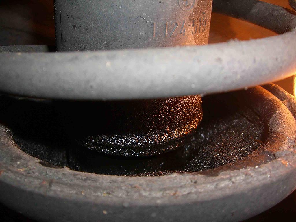

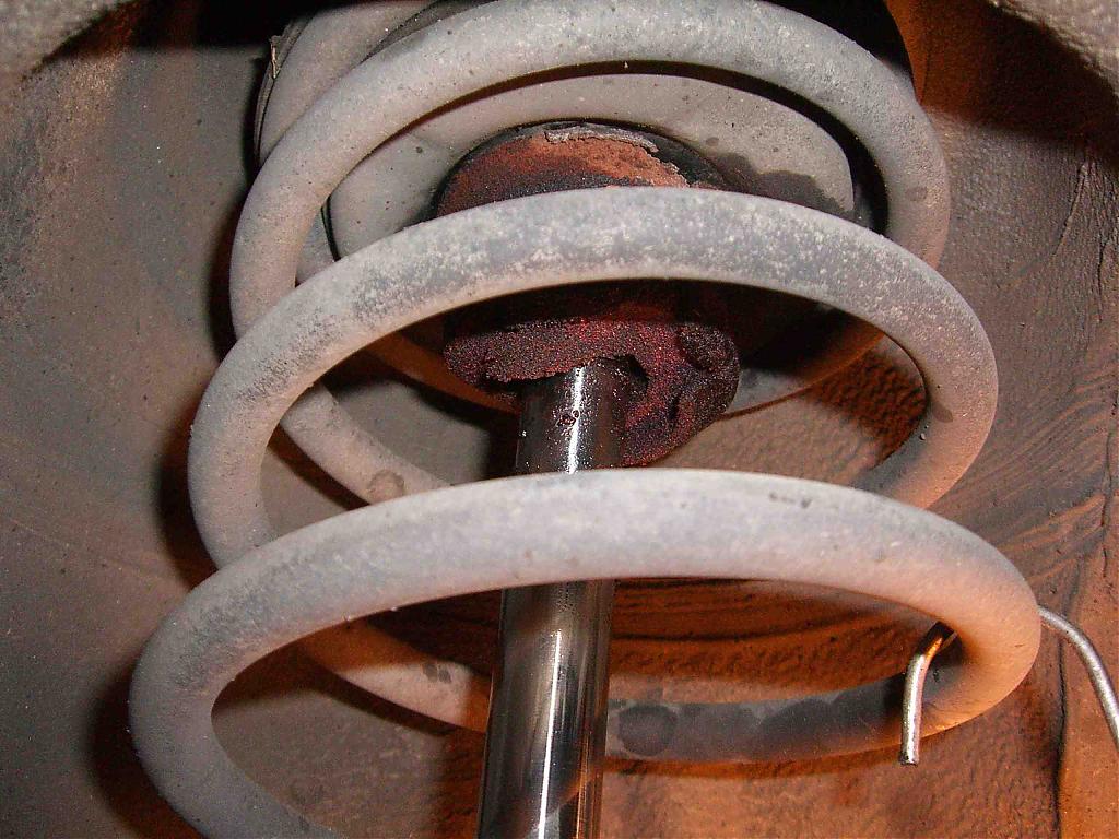

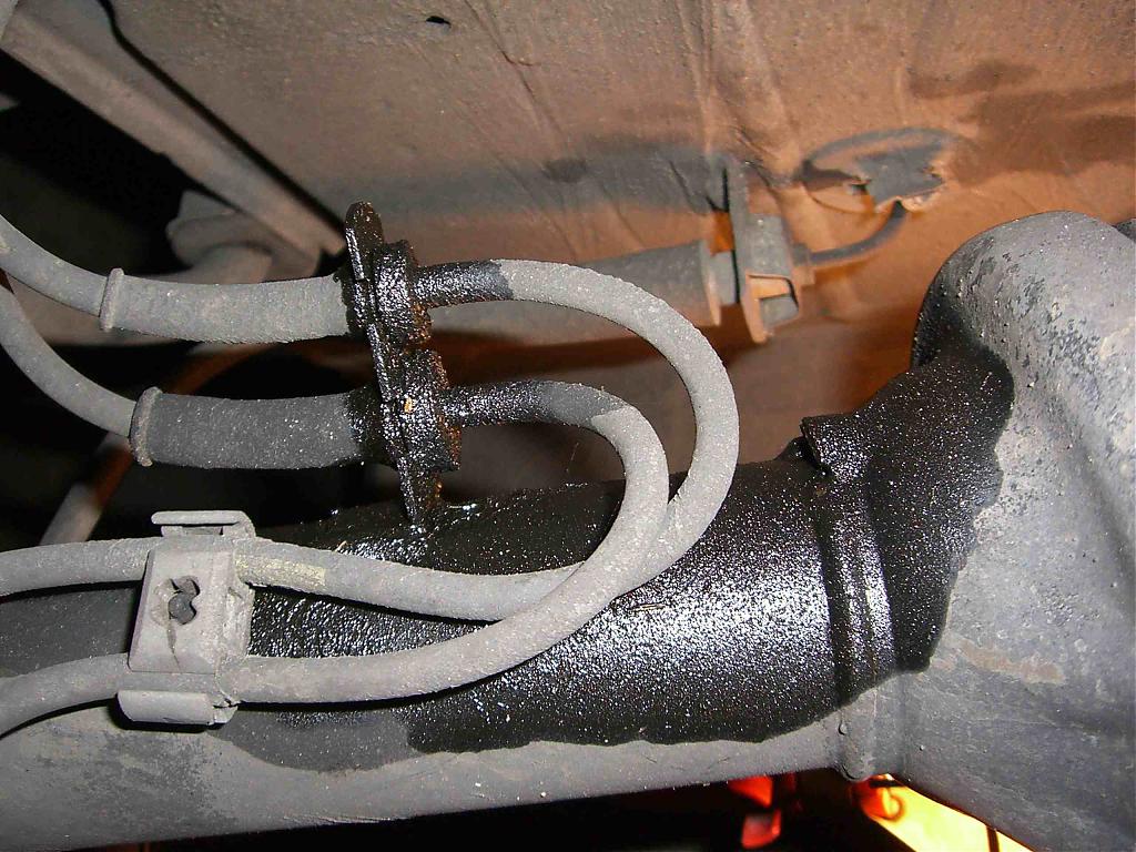

        i will give that a try. i think its the strut, heres some slightly better pictures. and also i disconnected the battery for a moment and now the idle is alot lower and when i rev it it dies or almost dies on the way down. is it just the computer just sorting things out or is there something i need to adjust. just seems like a bad day for my car:(
        • Teaguer
          • Sep 2004
          • 6167
          Yes , definitely a leaking strut insert .
          Replace them in pairs though .
          Don't buy any domestic or Asian crap ....hold out till you can buy Bilstein or Koni inserts .

                  Teaguer is right, poor quality pic I couldn't see what lines were what, but yeah that is a strut leak, Is your suspension sloppy?
                  • Wishno87
                    • 6025
                    i havent noticed any difference in handling recently. is that just the seals on the shock that are shot? and can i run them like this for a bit or do i need to replace them imediatly? im a little tight on cash right now
                    • redhatpat
                      • Aug 2005
                      • 656
                      You probably dont need to replace them immediately, but you're going to have some funky suspension movement from that side since there wont be any proper suspension damping from that strut.
