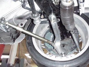

    where did these guys get the front control arm setup on this V8 swap? Is it in house made or does someone sell this setup?

    My guess would be custom/modified parts built up specifically for that use.

      Custom made RACE ONLY part.

        Custom made... there is a write up of how to do something similar on e30m3performance.com. The DTM e30s ran something like that.
        As far as race only is concerned I have no problem with that on a street car under one condition!... the rod ends must be treated as wear items and replaced AT LEAST once a year. Also using over sized washers under the rod end mounting should be mandatory from a safety stand point.
        High quality rod ends are basically stiction free and should give a better ride than the high friction urathane crap most people are using.

          those are made in house at AKG
