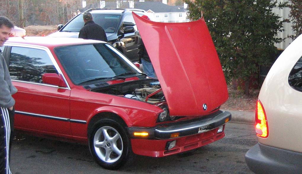

ps. don't take your car to a car wash they will wreck it!!!!!!!
(as the picture shows)
