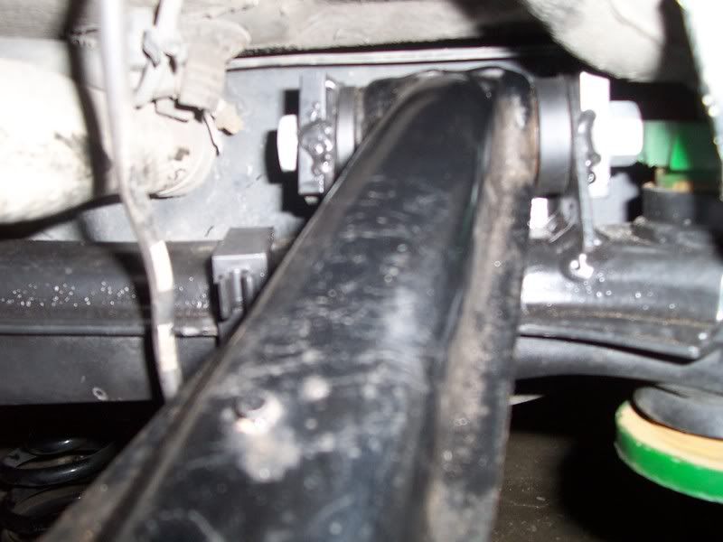

                  Here's mine that I just completed:
                  Grinding down an el-cheapo wrench doesn't sound like a bad idea actually. I haven't gotten it aligned yet only because I haven't gotten the front done yet. I know the left side toe is way in though.

                      [quote=e30_325es;1212125]Here's mine that I just completed:
                      I just got this thread, have the following question:
                      Cant figured out which side its the picture, but I was told the wider outer rubber goes always closer to the diff, and so goes the head of the bolt???? And so its shown on a diagram from the mountings vendor (I bought a brand Lemforder for those, and brand Meyle for the bigger ones on the TA`s support brace)
