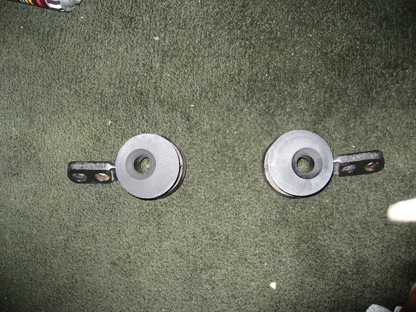

    Ordered a pair of offset M3 CAB's from Bimmerworld and they have no alignment arrow on them? The only I can find that closely resembles a alignment mark is 2 plus signs on one of the bushing with 05 & 06 under each of the plus signs. Any ideas or does it really matter, as long as they are close when pressed in the lollipop?
    Pic

    The alignment of the bushings in the lollipop arms isn't critical. Install the bushings in the lollipop arms so that the hole is closest to the arm.
      so the holes are closer to the inside of the car, right?
        Outside of the car, inside of the arm.
        Originally posted by Gruelius
          Here's a pic of how i presses my AKG CAB's in for reference:
            They wont fit if they are installed backwards. At least my AKG ones didn't...
