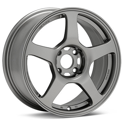

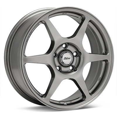

          Tire Rack also posted 2 more Kosei wheels that will be available in March.
          K2R in 15x7 et25
          K6R 15x8 et20!
          E30 325i 24v, E36 M3/4/5, MK2 GLI 16v, NA8 Miata
