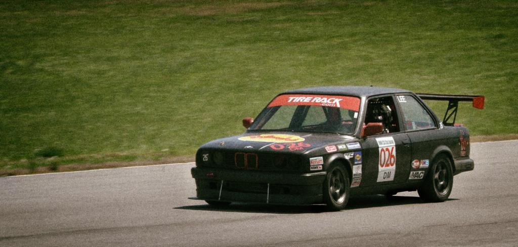

        I have the 15x8 K8Rs on my car with the 300x32 massive kit. Clearance is great.

                  These were from Tire Rack. 15x8 et20. They do need a hub centering ring, and originally came with plastic ones... but a quick note to my sales guy there and he sent me some nice aluminum ones.
                  I think they are great wheels - super cheap and very light weight. And I feel much more confident hitting curbing at the track with these over my last set of Rotas with about a million heat cycles.
                  The 225/50-15 Pirelli Trofeo Rs are cool too, but the massive balloon sidewalls rub pretty badly on the rear quarters even with an aggressive roll.

                    Great looking car. Wheels look great. Any close-up shots showing calipers and clearances?
                        Sorry this is the best I can do at the moment - car is sleeping for the winter in the barn and not very accessible.
                        '91 318is
