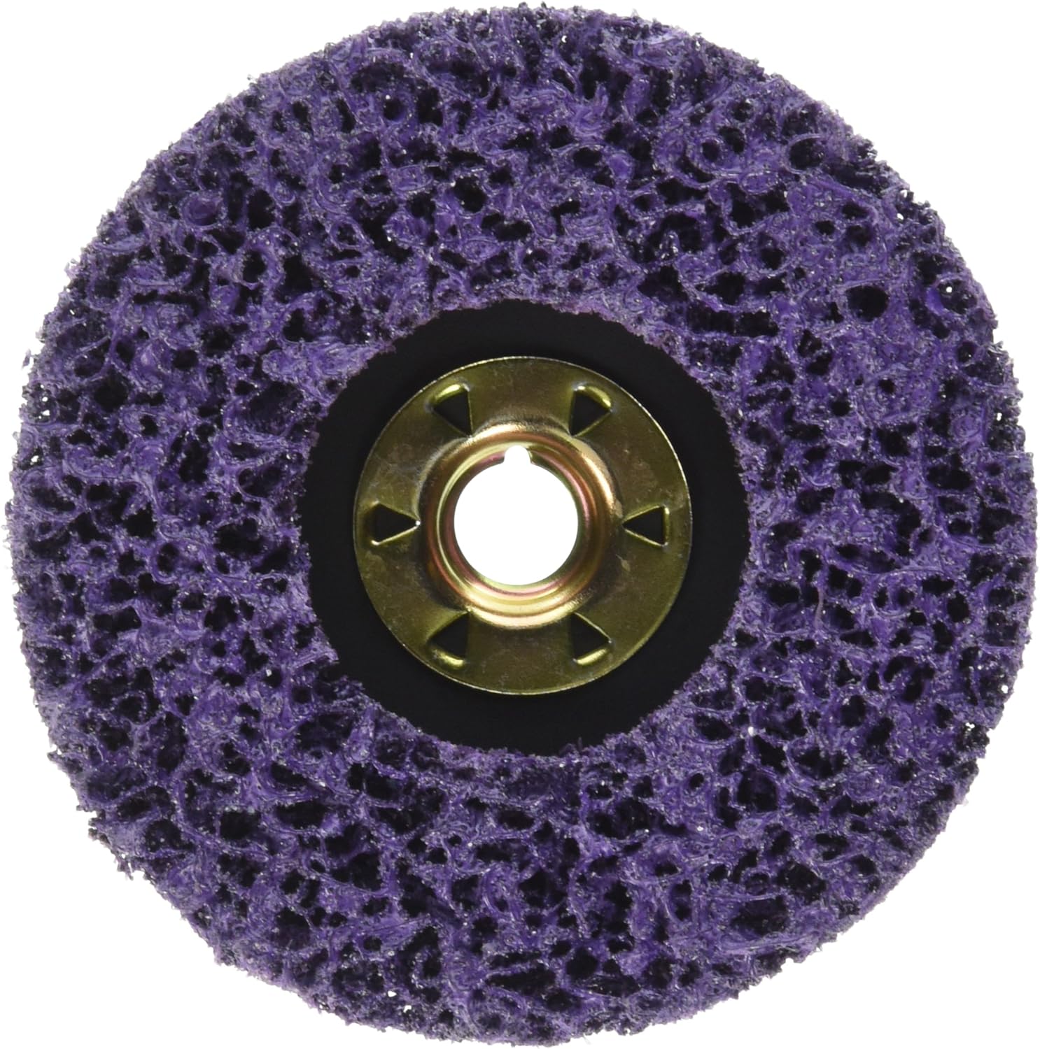

    Stripping paint from rear subframe and trailing arms
    Does anyone have some tips on how to get the subframe and TAs down to bare metal? I've been using strip discs on an angle grinder (like this https://images-na.ssl-images-amazon....AC_SL1500_.jpg) and it works great for the big parts, but the small spaces it just can't fit in there. I do not have a sandblaster unfortunately, and Jasco paint stripper doesn't seem to be working very well. I do not know what kind of paint is on there but it seems very thick..
