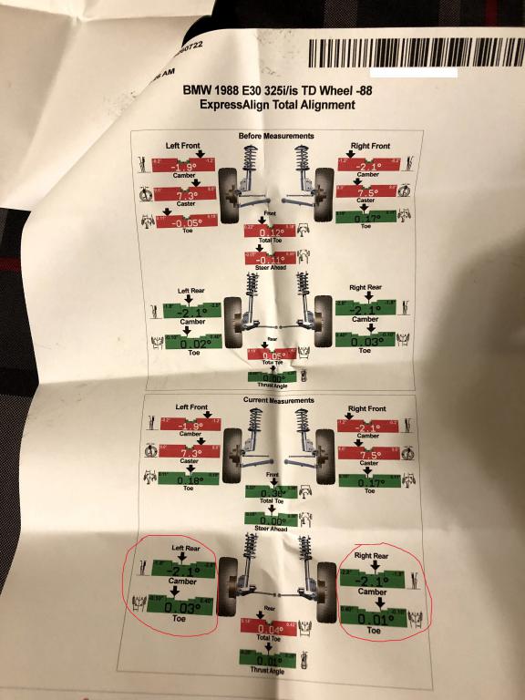

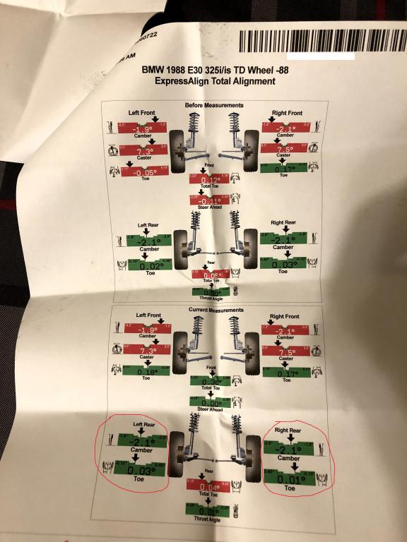

          Essentially, rear subframe riser bushings try to mitigate the adverse affects of lowering the rear of the e30 (crappy neg. camber and toe-in) by raising the subframe itself, effectively retaining the desirable suspension travel and handling characteristics that the e30 is known for. Here's a rough example: say you lower the ride-height of the car by 1 inch but raise the subframe by 1 inch. In theory, the rear of the car will retain the same handling characteristics (but obviously a bit less body roll). There are hundreds of other factors to consider, but this is just a rough explanation.
          Depending on how much the car is lowered, riser bushings can have a lot or little effect on geometry. From what I've read, if you significantly lower the car, the riser bushings will provide more correction (increasing marginal return haha).
          One negative from riser bushings is that you may experience less suspension clearance or driveline inbalances (weird driveshaft angle). For example, if you don't compensate by adding diff spacers.
          Weld-in tabs are nice for their adjustability, but one obvious con to the weld-in solution is that the eccentric bolts may move over time (unlikely but possible), which will throw off your rear alignment.
          IMO if you're not lowering the rear of the car more than ~1.5 inches and its just a street car, just throw some new bushings in and call it a day.
          In my case, my car is lowered ~1 inch in the rear (IE3 springs + spring pads) and has ~2 degrees of camber. This is totally static and I'm not using riser bushings or weld-in tabs. The toe is decent too. All 80a poly
