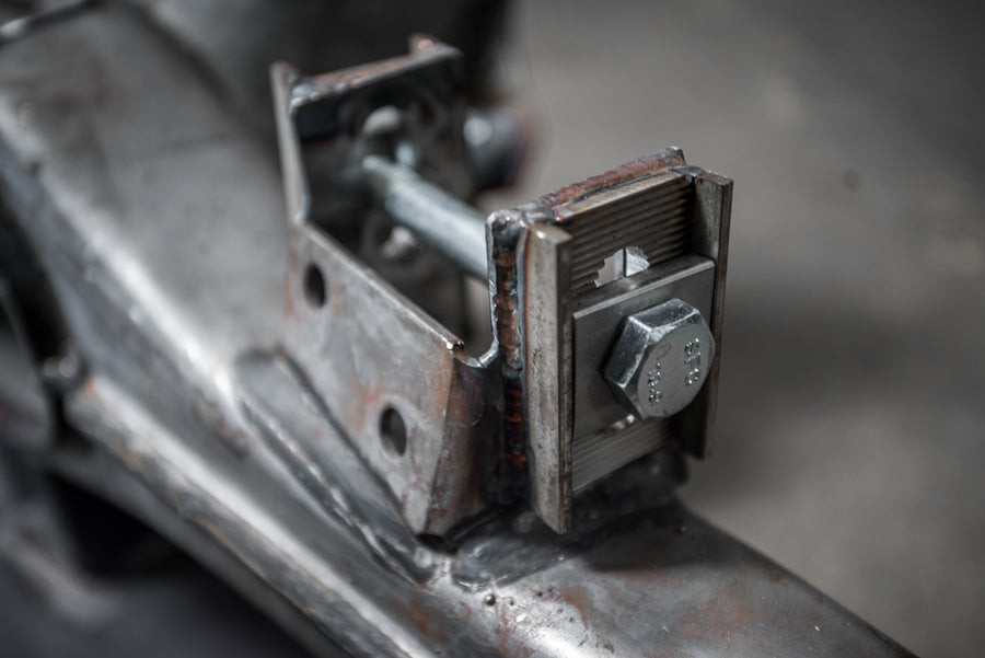

    I have 16 inch style 5's with 18mm adapters and am looking to run a 205/45/16 or 215/45/16 tire. I have heard since I wouldn't be going crazy low, subframe riser bushings would be sufficient to help the geometry, is this true? Is it worth it or necessary to buy the hardware from Garagistic and have it welded on? Also if i did buy the hardware, what is the main advantages/disadvantages of going with eccentric or serrated? Should I get riser bushings and the adjustable hardware?

    I just installed the serrated adjustable kit from Garagistic. I also am running a meaty 17" wheel with a 225 tire setup so the car does not sit crazy low. For me, it is very nice having the adjustability back there and I dont think the subframe riser kit is needed. Sure, if you can use the riser kit and it may help reduce excessive camber, but you will lack the adjustability if your alignment isnt perfect.
    Also, the serrated kit locks in the adjustment very well, but I have been having issues with the trailing arm bolts backing out. I ended up applying locktite to the threads and tightening a thin M12 nut (also locktite) on the exposed threads. So far, that seems to be working. The serrated kit also give you a greater range of adjustability over the eccentric kit, but both kits weld on to the subframe the same.

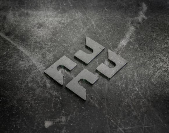

                What are the purpose of these included brackets? Click image for larger version

                • jbontke
                  • Mar 2019
                  • 449
                  It looks like they increase the height allowing for more range in adjustability.
